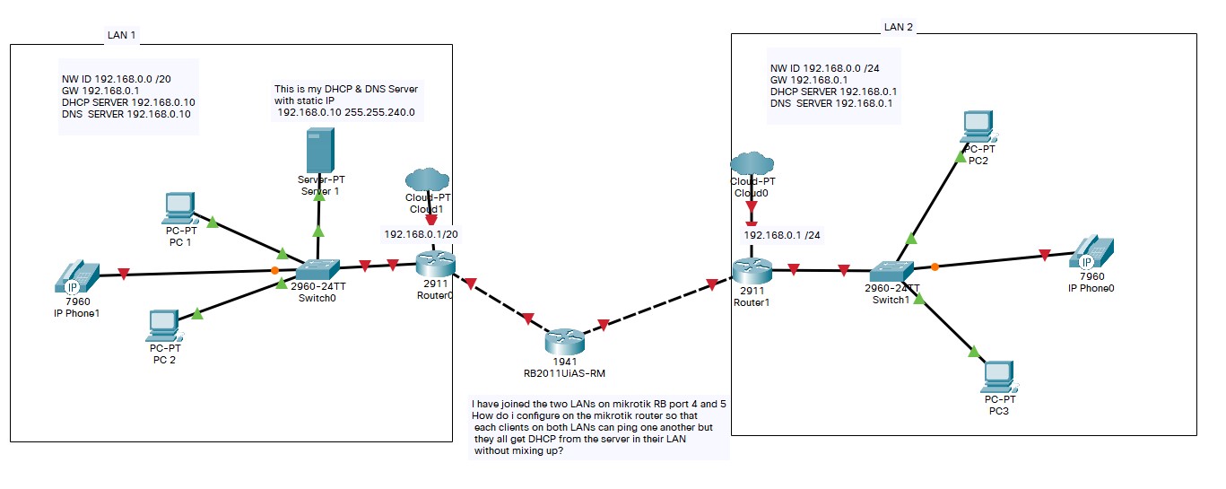

Connecting 2 Lans ,each LAN with its own DHCP server on RB2011
I have 2 LANs, in close proximity. I wish to connect the 2 LANs via a Mikrotik RB2011 Router on ether ports 4 & 5.
Each LAN has its own DHCP server, DNS and GW.
I wish to have clients on each LAN get IPs dynamically from their respective LAN without mixing up and also be able to ping one another.
LAN 1 NW ID 192.168.0.0 /20
GW 192.168.0.1
DHCP SERVER 192.168.0.10
DNS SERVER 192.168.0.10
LAN 2 NW ID 192.168.0.0 /24
GW 192.168.0.1
I have the two ports on bridge mode but DHCP requests are mixing up in both LANs, how do I fix this?

This isn’t going to work..
LAN2’s network is in use by LAN1.. LAN1 will never route traffic to LAN2 because it is already ‘local’ to LAN1.
Your routing needs to be done on the two 2911 routers.
What is the purpose of the RB2011 and why it is also labelled as a 1941?
How do you know this? Or how did you come to that conclusion?
If that is the case, your diagram doesn’t match your cabling and/or your 2911 configurations are very wrong.
Is this a homework question?
