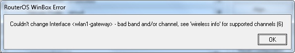

When scanning from the Station I can see the AP but when I try to connect to it i get an error saying:
"Couldn’t change Interface - bad band and/or channel, see ‘wireless info’ for supported channels (6)

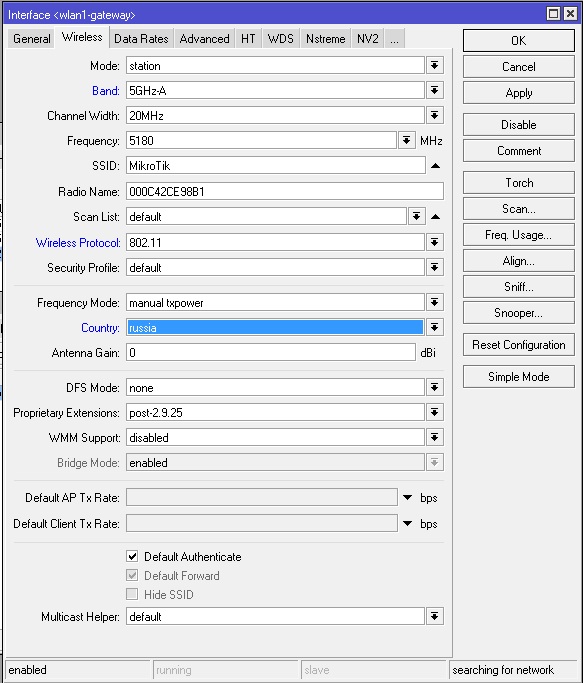

Good afternoon.
Same Issue, but in Russia. I have SXT 5HnD with packages version 5.18.
I put settings according http://minsvyaz.ru/common/upload/pr124-10.pdf document. And get problem. What should I do?
