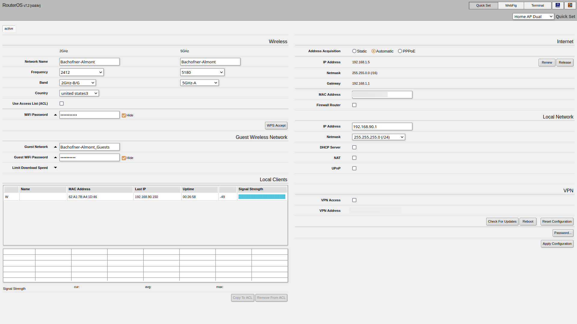

I have 2 MikroTik wAP-ACs which are connected to a Netgear GS324TP managed switch which is connected to an OpnSense router. ( One AP is at 192.168.1.5, the other @ 1.6 )
I would like the APs to serve both private and guest clients.
Private should ultimately be in VLAN 10 (192.168.10.x), guests in VLAN 90 (192.168.90.x)
I have attached a screenshot of a very initial configuration using (MikroTik Webfig’s) QuickSet, but of course this is at best only going to use one of the available VLANs (I put it all in the 90 for the moment).

EDIT: oops, somehow forgot the screenshot. Added.
