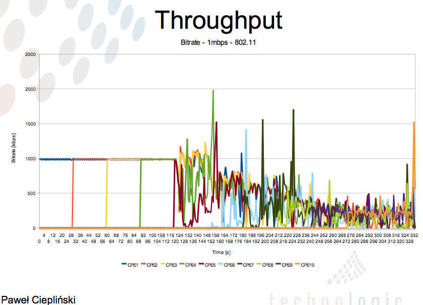

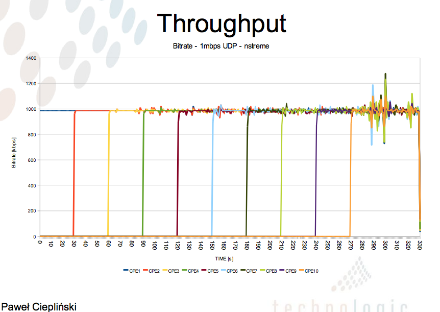

A picture is better than a thousand words:
10 stations, 802.1:
10 stations, nstreme:
Source: (Comparison of Wireless Protocols by Pawel Ciepliński
