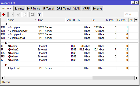

Here’s my interfaces now what to do?
Well it looks like you have pptp server running and already have uses connected
Now just setup your phones pptp client and your done

It looks like you have PPTP server allready up and running
If so are you trying to access from the WAN . Internet side?
If so you need a firewall rule to let you connect to your mikroptik PPTP Server from the internet and you need to take your phone off wireless and turn on your phones internet access with your provider and test access from there.

We have two routers and using mikrotik, we have no internet access when connecting wireless network but we use vpn to access the internet. I myself didn’t configure the VPN but I send an image of interfaces.
This VPN completely works with windows and it doesn’t it is PPTP or L2TP or anything else just username and password.
