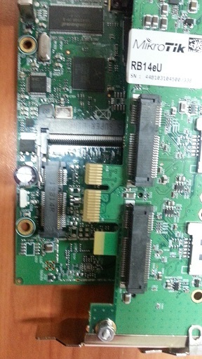

RB14eU has PCIe connector. How do you plan to connect it to the RB411 and why? It is a card for x86 machine
http://routerboard.com/RB14eU
if I use this a MiniPCI Express to PCI Express Adapter?
RB411U doesn’t have PCIE pins connected to the mini-pcie slot - it has only USB pins connected.

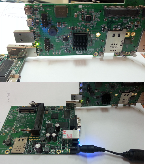

make a picture of this setup so we could see it.
sorry for the delay ,
here
you need to plug the RB14eU card into the PCI-E slot of the x86 box so it would get the 3.3V power to the mini-pcie slots.

OK, there are no Routerboard that will be able to power RB14eU, so you need x86 box for that, or some other way to power it.
When power is sorted Then when it is done you can connect USB cable RB14eU (that is still connected in x86) into the RB411.
But i suggest to just use x86 box for this solution :slight_smile:
