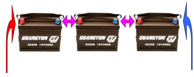

And I said it clearly. 3 6 volt batteries do not equate to 18 volts.
Hi ;
no connect the three batteries in series , the current will be the same but the voltage will be the sum
with best regards .
I have to agree, 3 times 6 = 18. I’ve checked a number of calulators and they all agree :slight_smile:
what kind of charger will charge the battery while it is being discharge by the load at the same time?
Your nominal 18V (3 x 6v in series) will actually be about 21 volts when fully charged and sitting at float voltage, which is a great place to run one of the newer RBs.
What most people call a 12v system is actually 14v, and 24v is actually 28v. It DOES make a difference, don’t ask me how I know…

I stand corrected. I was taught each step in the series doubled the voltage which is incorrect.
i.e. 12 + 12 does equal 24
but 12 + 12 + 12 does not equal 48
