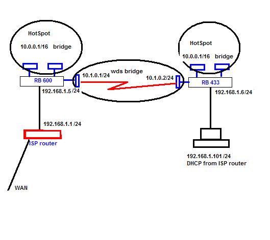

PPPoE has nothing to do with Hotspot. Wrong example, forget about it. Better show us your network setup with a simple diagram picture.
Here is topology.
RB600 is the main router on witch I have installed User Manager and RB433 is the remote router.
I have setup the network, I can ping all IP adress from RB600 and RB433.
I have setup usermenager on the RB600 and it is workin nice. So, now I have a problem, how to connect RB433 aothorization to the RB600 user manager.

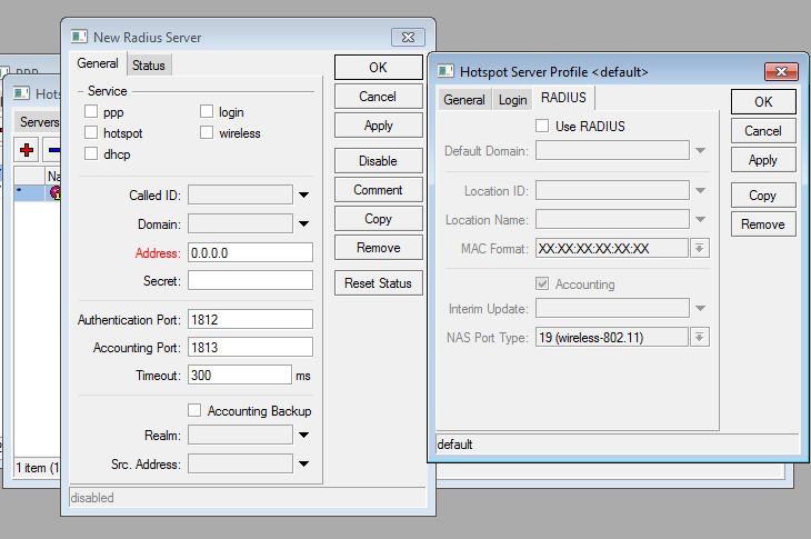

in RB433 you just have to set it to use RADIUS.
Dont forget to include the ip of your RB433 to the list of routers in user manager on RB600.
/tool user-manager router add ip-address=x.x.x.x shared-secret=xxxxxx
You can also do this in the web interface of user manager.
