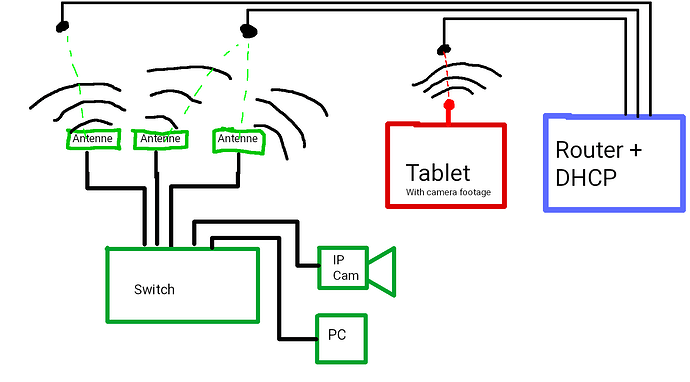

Hi there. I’m new to configuring MikroTik devices.
I’m struggling with this for a few days now… The scenario:
I have 3 MikroTik antenna’s, and 1 MikroTik smart-switch. The switch is behind the 3 antenna’s.
The antenna’s should be able to connect to an existing WiFi network. There is not guarantee that the AP’s on the existing network are MikroTik devices as well. But it does have an DHCP server.
In the meantime the camera that is attached to the switch, behind the 3 antenna’s should be able to stream video over the existing network, towards a tablet.
See below:
I was able to connect ‘wlo1’ of each antenna to the existing network with the use of WinBox… but other than that, I’m completely clueless…
The IP Camera , and actually also the PC should be accessible from the existing network. So they need to obtain an IP as well from that DHCP server. I’m open for workarounds as well.
Can you point me into the right direction? tutorials / video, or help me on the spot here ? what should I look for?
Start by listing the EXACT models of devices involved, including the Mikrotik "antennas", the camera and the switch, and - possibly - also those of the AP's and router.
Then - if you can - please explain the rationale behind the setup scheme you posted.
From that it seems that you want THREE connections between the same switch (and devices attached to it, IP camera and PC) and the SAME wireless network (SSID) with TWO connections to the same AP and a third one to another one.
Usually the switch (and devices connected to it) would be connected to ONLY ONE "antenna" connected to ONLY ONE AP (and ONLY ONE SSID), but of course there might be reasons to adopt a different scheme.

The reason:
The camera is too far for a direct connection to reach. ( Say if the antenna's were set up as a hotspot ). so the camera footage needs to be going trough an existing network that spans accross a very wide area. The antenna's, switch, camera and the PC (all green boxes) are mounted on a Rover, and can more around. possibly get out of reach of AP’s it was connected to, and into reach or other AP’s. It needs to then at that point automatically connect with the other AP’s
It does not actually matter which antenna connects to which AP. The reason we want to use 3 antenna's is so that we want to make sure there are no blind spots. Note that these antenna's are not omni directional.
The drawing is just an example of how it could be connected to the AP's.
Hmmm.
On a mobile (in the sense of having wheels, tracks or legs) something it would make sense (to me) to put an omnidirectional antenna.
This "antenna" (actually antenna with integrated router) needs to be put in one of the available "station" (please read as "client") modes, since the AP (s) is/are not necessarily Mikrotik.
This means either station (L3, no L2) or station-pseudobridge (not really L2, someone calls it L2.5 as it is pseudo-L2).
With three "antennas", let's say for simplicity that each one is exactly 120° wide, and that they are called 1, 2 and 3 what will happen when the AP exits the coverage of antenna1 (because the rover turns/rotates clockwise)?
The AP will only be visible to antenna2 now, so how will the connection be transitioned from going through antenna1 to going through antenna2? (please read as going through router1 to going through router2)
Possibly a failover of some kind?
But it will take several seconds to pass from one antenna to the other, I believe.
If the rover turns alternately (say) 15° left and 15° right when on the border between two anntennas coverage it will fail to connect for minutes.
From the looks of that Wandy thingy, it is a routerboard of some kind coupled to a (directional) panel antenna, as I see it (but I well may be wrong) , it should be possible to mod one of those to use an omnidirectional antenna.
But really, what you want is either a Netmetal or a Groove (and an omnidirectional antenna).
