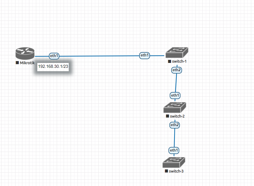

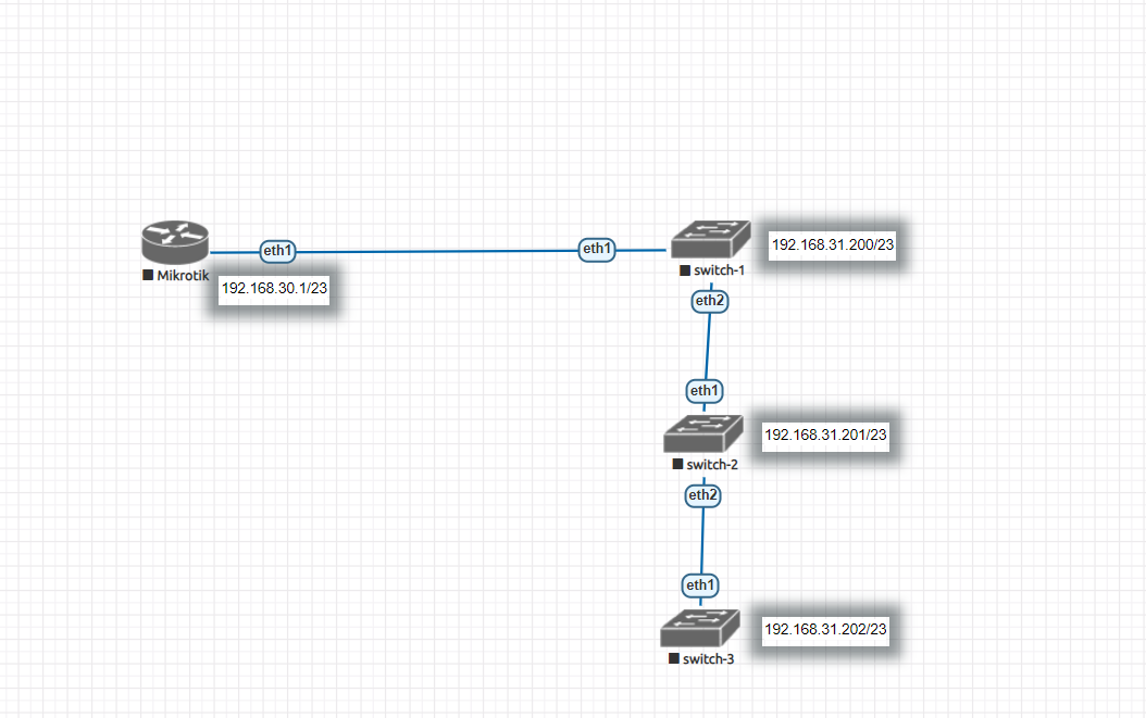

hello Mr Anav …! well you are right . so this is the config
1-i am using CRS326-24G-2S+RM Mikrotik Switchs
2-maybe this picture below clarify my senario
3-so the purpose of this config is just to make all this switchs as one switch so all of them must redistribute the 192.168.30.1/23 ip range with out any loop issue
if you want use those switch only as switch, and all is controlled from main router,
after you check that you are able to use winbox with MAC address,
install routeros 6.48.6 (long term),
after reboot update firmware on system/routerboard and reboot
at this point wipe completely the device,
with system / reset configuration, selecting only “no default configuration”
at reboot the device is perfectly “blank”.
paste this on terminal, remember to set the right IP, at the end, on last line, for each switch:
/int bridge
remove [find]
add name=bri-lan protocol-mode=none
/int bridge port
remove [find]
:foreach interfacciaTest in=[/int ethernet find where name!=“ether1”] do={add bridge=bri-lan interface=$interfacciaTest}
/int bridge
set bri-lan admin-mac=[/int ethernet get [/int bri port get ([find]->0) interface] mac-address] auto-mac=no
/ip service
set api disabled=yes
set api-ssl disabled=yes
set ftp disabled=yes
set ssh disabled=yes
set telnet disabled=yes
set winbox disabled=no port=8291
set www disabled=no port=80
set www-ssl disabled=yes
/ip dns set allow-remote-requests=no servers=192.168.30.1
remove [find where !dynamic]
add distance=1 gateway=192.168.30.1
remove [find]
add interface=bri-lan address=192.168.31.201/23
at this point secure your router selecting the right username and password on system / users
ask @Anav for firewall rules and other practices to protect router admin access
you can link the switch on any port, (except ether1 reserved for MGMT) but if you want follow some schema,
put ether2 on previous switch, or on the router if is the first switch, and last ether23 port to the next switch ether2
leave alone ether1 for MGMT and try to leave unused the ether24 inside the rack for “LAN Access” for test purposes if you need a free port to connect your laptop for do some test.
Probably you already know that, but if you do not know, the “console” port is not one ethernet port for manage the device,
but is a “cisco style” serial port that need dedicated cable for work as serial terminal.
Very thanksful Me @rextended for your help, my sincerly regards..! I will apply your command and tell you the result.
Hello Mr rextended..!
So i apply your rules and now my system works normal, depending on your config, so very thanksful..!. However, i encoumter - (not a problem) - but it is just a small issue in route table for switch-3 and switch-4 and really want ro understand why such thing happen.
You can see what i encounter in my new topic in this forum.
For the security issue i apply some rules in the main router from the mikrorik default configuration that comes with the router default settings.
