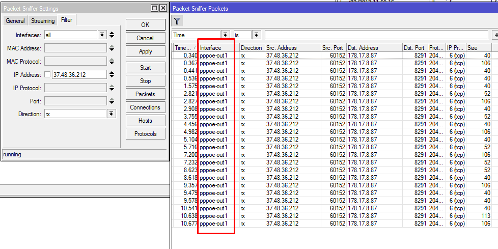

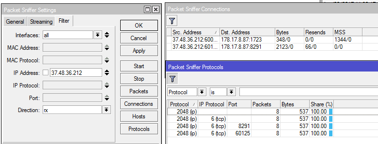

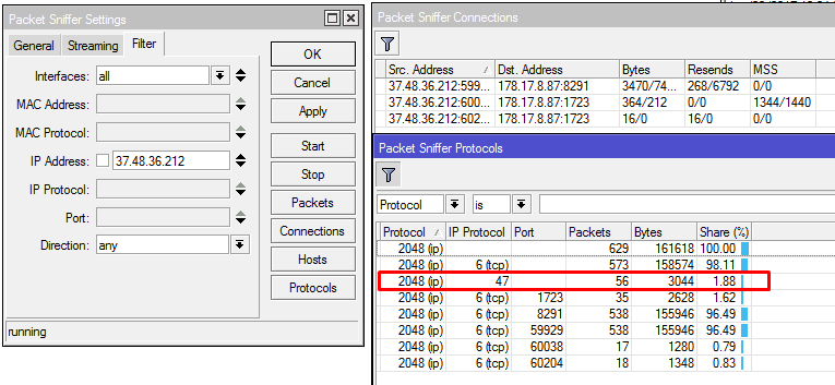

  • GRE is visible on packet sniffer, see picture
Could that 47 traffic be outgoing traffic?
Maybe sniff for “rx” only…
Yes, you are probably right, there is no incomming traffix on GRE protocol. I’ll ask my ISP to check its wifi router setting if they are blocking GRE and let you know later. Thanks.
