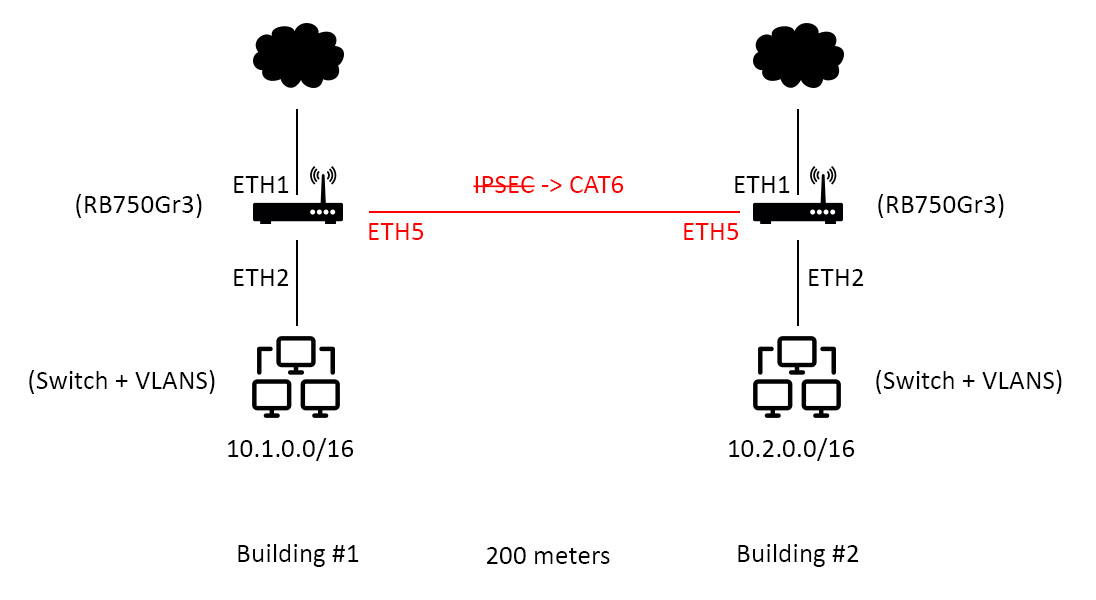

Hi Everyone,
  • We have 2 buildings, 2 routers, 2 internet connections
  • Each has is own dhcp and vlans
  • Currently the networks are bridged with an ipsec tunnel, which works well
  • Since the buildings aren’t that far apart, I would like to connect the routers on their ETH5 by running a CAT6 cable
  • Preferably I would keep the current topology and make it work as the current ipsec tunnel (separate vlans, dhcp, internet connections etc)
My question: What do I need to configure after connecting the cable to the 2 router’s ETH5 ports?
Well I see a conflict as both routers are providing DHCP?
What would be the purpose of ether5 on both routers, in other words what does the connectivity allow…

To provide faster connectivity than ipsec between the two buildings.
I may have overstated the actual distance, it wouldn’t be over 100 meters. Optical can be an option by switching to RB760iGS and using an SFP module.
I think I get the general idea what you suggest. You mean like this?
IP → address:
  • Router #1 = Address: 10.99.0.1/30, Interface: Eth5
  • Router #2 = Address: 10.99.0.2/30, Interface: Eth5
IP → routes:
  • Router #1 = 10.2.0.0/16, Gateway: Eth5
  • Router #2 = 10.1.0.0/16, Gateway: Eth5
I’d use “the other end’s” IP address as gateway:
  • Router #1
/ip route add dst-address=10.2.0.0/16 gateway=10.99.0.2
  • Router #2
/ip route add dst-address=10.1.0.0/16 gateway=10.99.0.1
