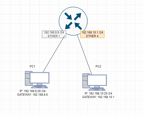

I attach the topology, PC1 has no connection to PC2

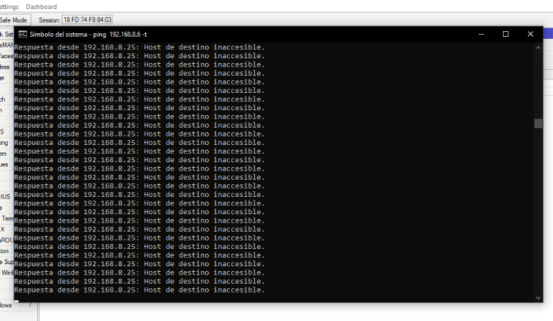

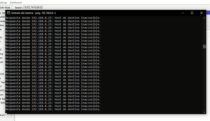

attached ping from PC2 to PC1

I don’t see any errors, find the problem on PCs, is something missing, like correct subnet, gateway or firewall enabled?
Or is there another device in the middle that is interfering…
PC is once 8.50, then 8.20, why ping 8.25?
And one time it’s ether2, the other time ether4…
What a mess…
On the screen we see that ping is done to the 8.6 and reply is from 8.25. Theoretically should be from 8.20?
