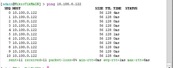

But from B to A don’t working (I tried pinging from 10.100.0.122 to 10.100.0.60).

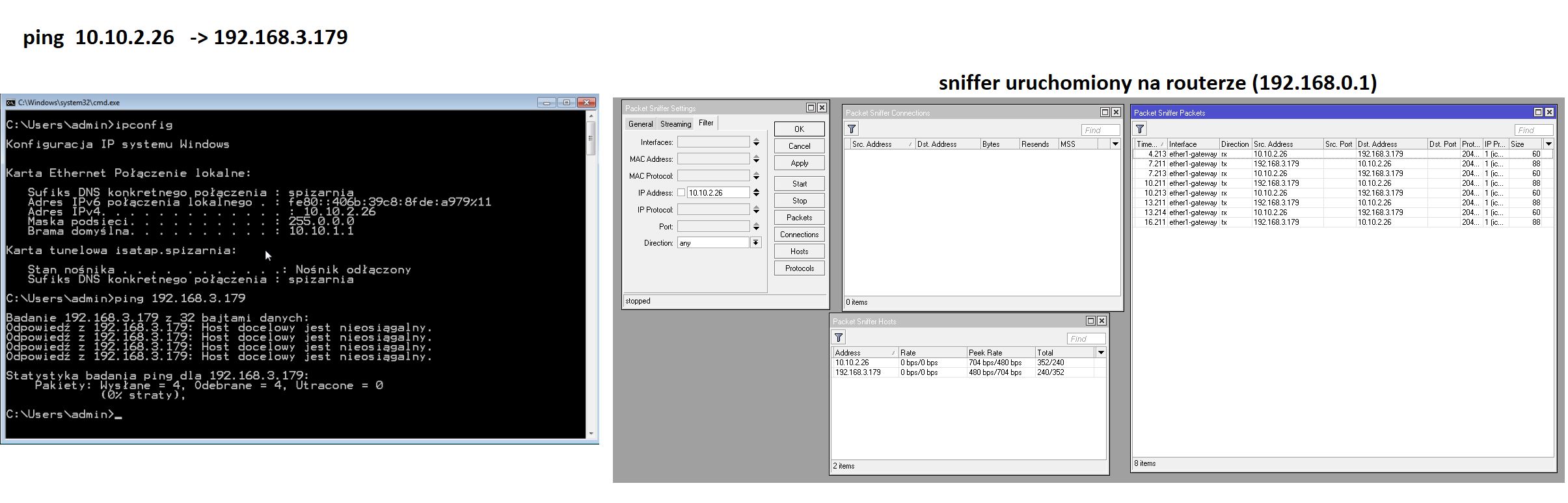

Pinging from 10.0.0.0/8 network host in 192.168.0.0/16 network (exactly pinging 192.168.3.179 from 10.10.2.26) packets reach the router network 192.168.0.0/16 (192.168.0.1) - can see it in the sniffer on the router, but they do not reach the host anymore (empty log on wireshark).

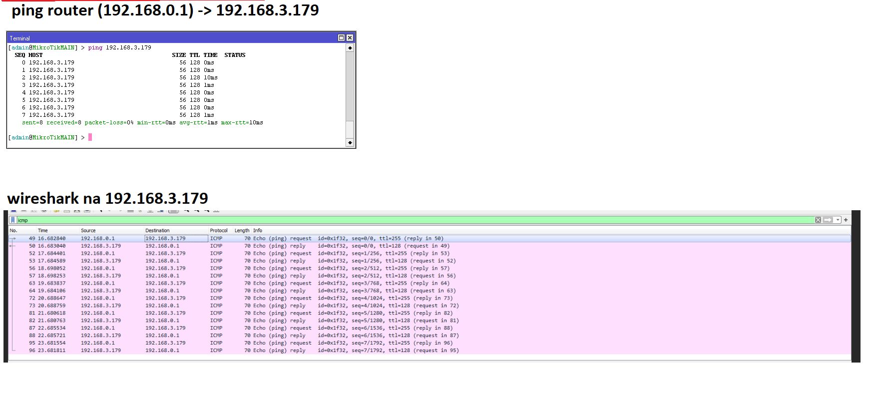

However, ping from the router (192.168.0.1) to this host (192.168.3.179) passes without any problem.
The ping in the second direction (i.e. from 192.168.3.179 to 10.10.2.26) goes correctly.
So the MikroTik router is receiving the ICMP traffic from the host behind the PF Sense firewall and sending it back.
Have you performed a capture on the PF Sense FW to see if it receives the traffic? It seems like your issue is in PF Sense based on the data you sent. The MikroTik is routing correctly.
Mikrotik receives ICMP traffic from 10.10.2.26, but does not forward it to192.168.3.179.
