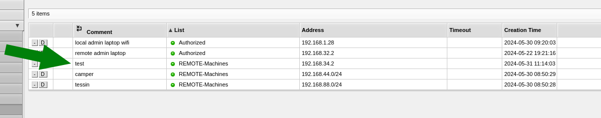

/ip firewall address-list
add address=192.168.1.X/32 list=Authorized comment=“local admin PC wired”
add address=192.168.1.Y/32 list=Authorized comment=“local admin laptop wifi”
add address=192.168.1.Z/32 list=Authorized comment=“local admin smartphone wifi”
add address=192.168.32.2/32 list=Authorized comment=“remote admin laptop”
add address=192.168.32.2/32 list=Authorized comment=“remote admin smartphone”

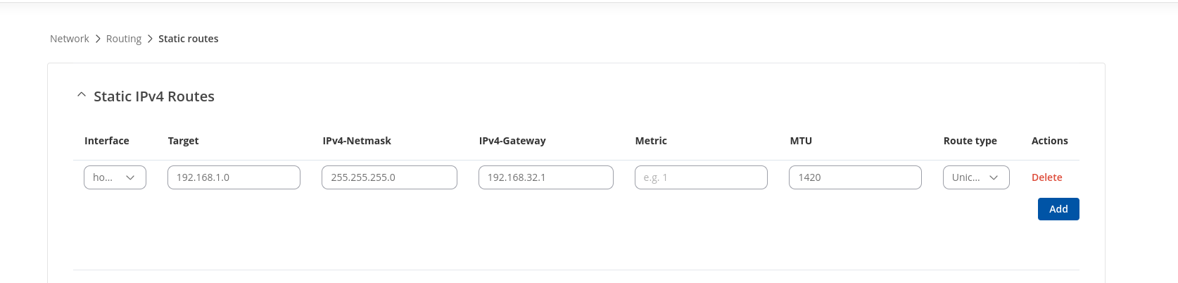

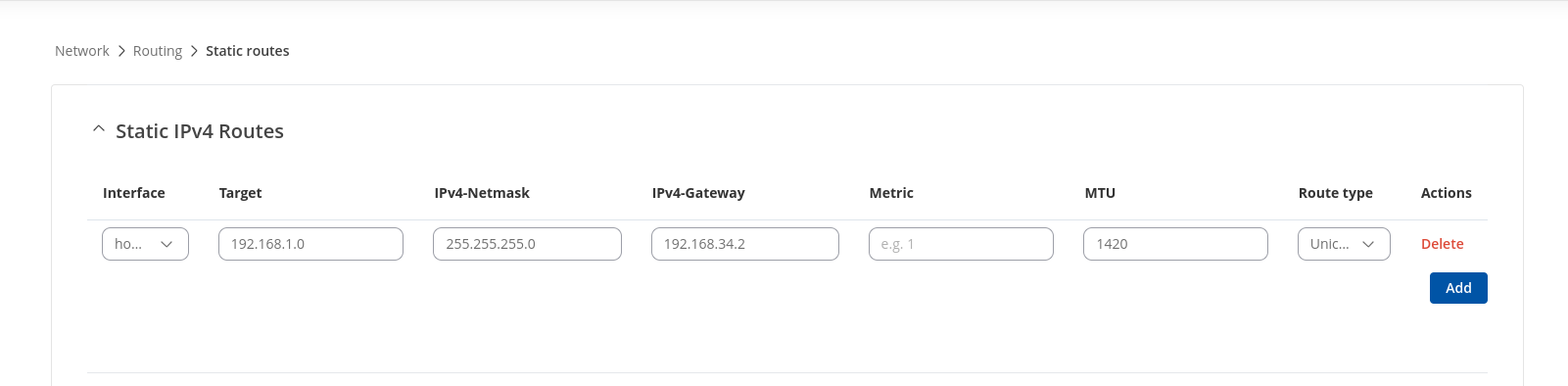

Regarding those two peers, I’ll explain what I want to do:
Tessin is a house (remote) with it’s own LAN (192.168.88.x).
Camper is a Camper Van (remote) with it’s own LAN (192.168.44.x)
Both have a couple of devices that need to send data to my Home Network (the one we are configuring here, 192.168.1.x).
I am using Wireguard to let them connect to my Home network if they are online (as it works in both directions, this is fine).
I want to:
  • Connect to machines in my home network (192.168.1.1) from machines in the Camper/Tessin networks.
  • Connect to machines in the Camper/Tessin networks from my Home network.
So, in contrast to these road warrior setups, it’s a site-to-site setup, and I followed this tutorial:
https://www.youtube.com/watch?v=CH10spRyGpU which was previously working.

However, in order to access the remote machines from home, don’t I need the interfaces, so I use routes like this:
add disabled=no distance=1 dst-address=192.168.88.0/24 gateway=tessin
pref-src=“” routing-table=main suppress-hw-offload=no
add disabled=no distance=1 dst-address=192.168.44.0/24 gateway=camper

I figured I need routes on the RUT950 too:
But without success… do you have any idea what could be missing?

I’m unsure which IP I have to use for the routing config on the RUT950 (correct, that’s the other router).
I guess then I have to use the IP of the tunnel, which would be 192.168.34.2.
Regarding the netmask, I can only specify IP and netmask separately, that’s why it looks like it’s the IP:
config.txt (10 KB)
yeah that route looks better… and if not try 192.168.34.1 as an alternative.

I think I found the problem, I need to add the IP of the peer to REMOTE_MACHINES:
I’m not sure how this works, but the other entries might then be obsolete if it just uses the Peer IP.
If that works, that means maybe at the other router you are source natting the outputs so they dont actually come from .44 they are coming from 34.2 ???
IN that case adding it to remote-machines should allow that traffic to reach LAN devices on the MT LAN.
Allowed IPs on that router should be
