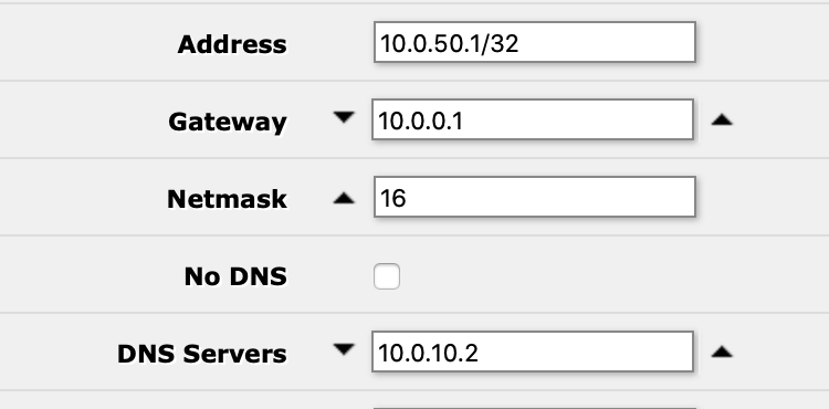

Experience some heavy connection problems when using my iPhone 8 with iOS 13.3 and RouterOS 6.46.2 on a small hEX router…
As soon I remove the fixed DHCP lease the problem is gone…sometimes it helps just to renew the lease (turn WLAN off/on).
Is this the correct way to enter a fixed lease in the DHCP Server → Network tab with local prefix being 10/16?

Network tab is there to set DHCP some of the values sent by DHCP server inside DHCP offer/ack packets.
To set a static IP address, you need to go to DHCP Server > Leases tab.
Also, the network address has the wrong mask in your screenshot.
