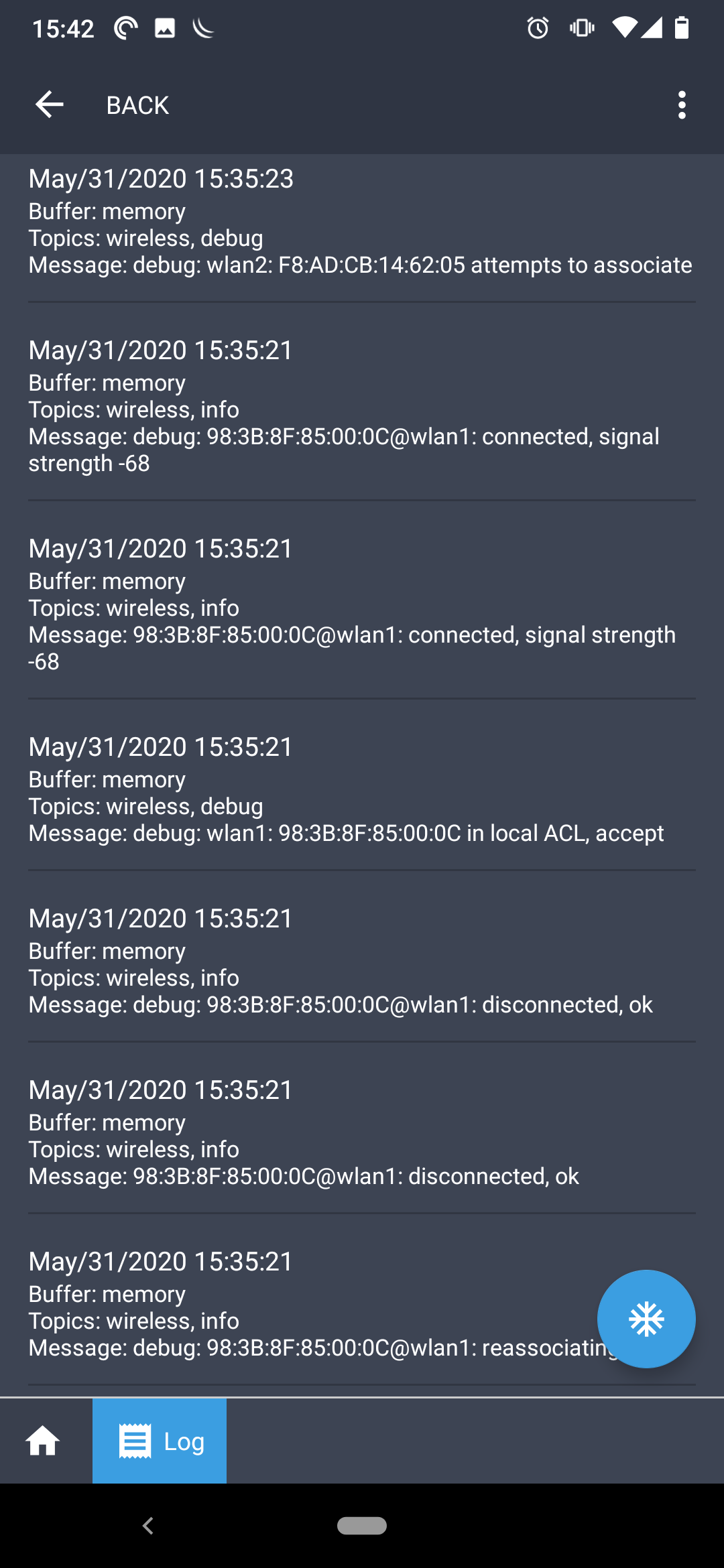

  2. I took a screenshot of off my phone with a bunch of logs that may or may not be pertinent to the issue. I am honestly having difficulty making heads or tails from it. If someone is able to do so, that would be a big help. Here is the screenshot:
https://i.imgur.com/zXo4dXL.png

  1. I took a screenshot of off my phone with a bunch of logs that may or may not be pertinent to the issue. I am honestly having difficulty making heads or tails from it. If someone is able to do so, that would be a big help. Here is the screenshot:
Yes the problem is described there. The client disconnects from WLAN1, and immediately reconnects, however it is not able to re-associate. (5 seconds later)
The reason is not clear yet.

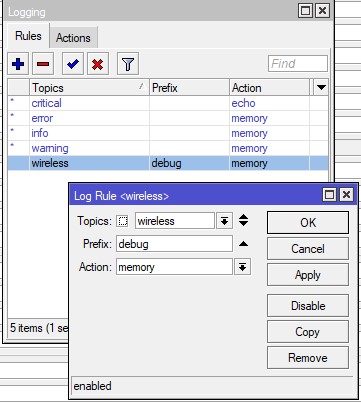

If we want to see more information on the wifi connect-disconnect process, you should extend the “/system logging” setting with topic “wireless” prefix “debug”

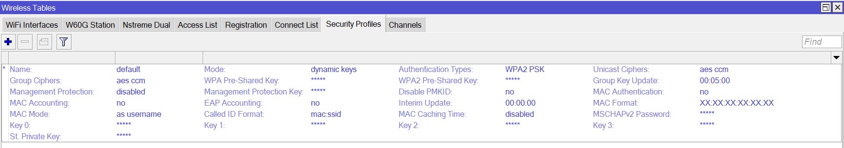

The client device decides where to connect to, and when to change connections (roaming). If WLAN1 and WLAN2 have the same SSID then the PC is free to choose. It will normally choose the strongest one, but other saved information may also play a role. So if the signal or internet connection fluctuates it may roam to the other WLAN. If the security profile is different for those SSID’s then there might be a problem is connecting. Limit the security profile to WPA2-PSK and AES only (no TKIP, no WPA), if possible for your client devices.

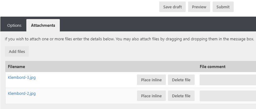

PS: screenshots in this forum. Capture the image you want, (easy in WIN10 … “shift-Windows-S” and cut out the part you want, save it in a file like .jpg or other) , at the bottom of the post-editor is the possibility for attachments, and they can be placed inline. Preview the post to see.

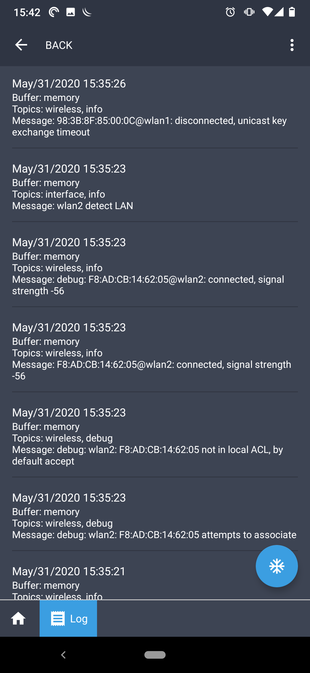

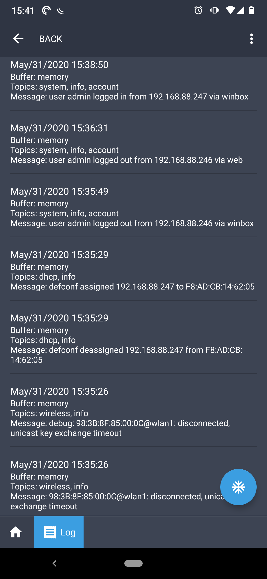

  2. I added the log rule as suggested. Here they are (again from my phone).
  3. I think the security profile was already limited to WPA2 PSK and AES.

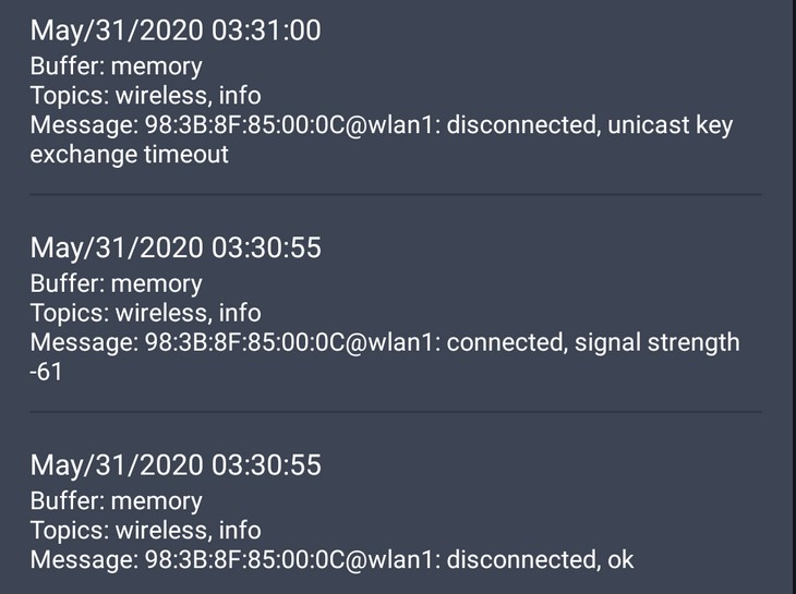

The only thing I see is normal reconnects. (But one device in the access list, the others are default.) No refusal to reconnect.
The “unicast key exchange timeout” may be a problem that last longer than the reconnect. It looks as if your 2.4GHz band has a lot of interference. Did you check the channel usage, before picking channel 1,6 or 11? Tools “Freq usage”, and “Wireless Snooper” will help “see” the environment you are in.
http://forum.mikrotik.com/t/rb951g-2hnd-unicast-key-exchange-timeout/104896/1
