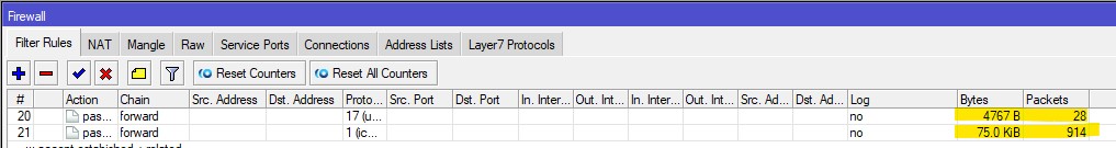

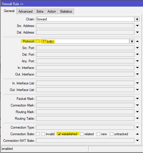

I can create Firewall-Filter-Rules:
UDP + Connection State = established → Action Passthrough
ICMP + Connection State = established → Action Passthrough
Both rules match to certain packets. Now, this cant be the “TCP-Connection State established” because these are non-TCP-packets.

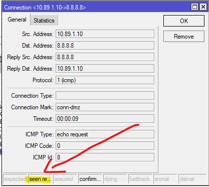

Does the “seen reply” flag in the Conn-Tracking means this is “established” (for TCP AND non-TCP-Traffic)?
And does this apply to “related” non-TCP-Traffic as well?

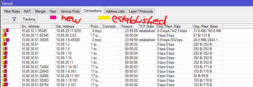

Unfortunately the Connection-Tracking show nowhere “new”, “established”…
C = new
SC = established
