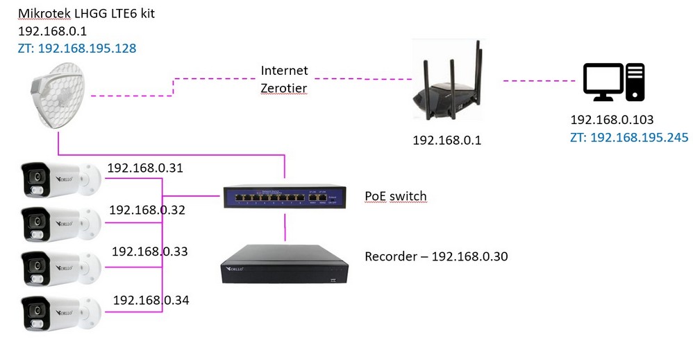

I am trying to get remote access from Windows PC (192.168.0.103 ; ZT: 192.168.195.245) to IP cameras (192.168.0.31-34) connected to Mikrotik LHGG LTE6 kit (192.168.0.1 ; ZT: 192.168.195.128) . I am attaching configuration on the picture.
I have installed zerotier on my PC and on Mikrotek router.
Right now, I can connect from PC to router via web interface using ZT address and Winbox. I would like also to have possibility to access recorder and cameras using browser.
I tried it using port forwarding on Mikrotek but I failed – seems that my experience with simple home routers is far not enough…
What is the simplest way to do it? Using port forwarding or somehow getting Zerotier IP addresses for cameras to connect to them directly?
Thank you in advance.
Shouldn’t be too difficult but you got a potential problem which is not related to zerotier.
Your PC network and camera network have the same subnet definition.
So the router which serves your PC, doesn’t know it should go elsewhere for those devices.
And your ZT access runs on your PC, not on your router.
You might be able to solve it using port-mapping on LHGG kit.
E.g.
192.168.195.128:8030 gets translated locally to 192.168.0.30:80 (or whatever port is needed)
192.168.195.128:8031 gets translated locally to 192.168.0.31:80 (or whatever port is needed)
High-level view, let’s first see what others come up with.

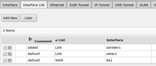

  1. Add the ZeroTier interface on your LHGG to the “LAN” interface list. (WinBox: Interfaces->Interface List)

Then have added ZeroTier interface on LHGG to the “LAN” interface list:

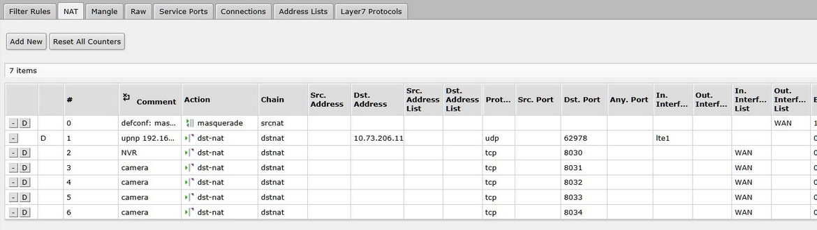

I have forwarded cameras and recorder to LHGG ports 8030-8034:

BTW, disable or remove all DST-NAT addresses (using the WAN address list) that would allow anyone on the internet access to your cameras. Use Zerotier instead.
