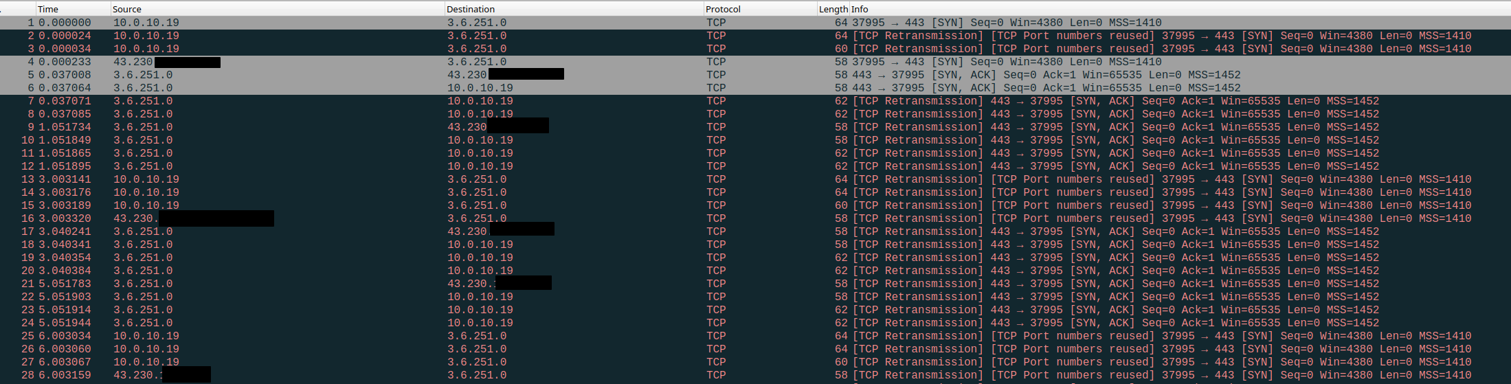

This was captured on all interfaces. 10.0.10.19 sends a SYN packet to 3.6.251.0, It’s masqueraded to the public address of WAN and then sent to destination. The destination sends back syn+ack. Routers switches it back to the LAN address and sends SYN+ACK to 10.0.10.19.
Some how, 10.0.10.19 never receives this syn+ack packet and sends a syn packet again. This keeps happening in a loop.
While this was happening, I had ping 10.0.10.19 running separately and it was working perfectly fine. (~50-70ms latency, 0 packet loss).
I thought maybe this is an issue with the device at 10.0.10.19 but every thing works perfectly(no stuck connections) if I make a hotspot on my phone and try to connect that device to my phone’s network.

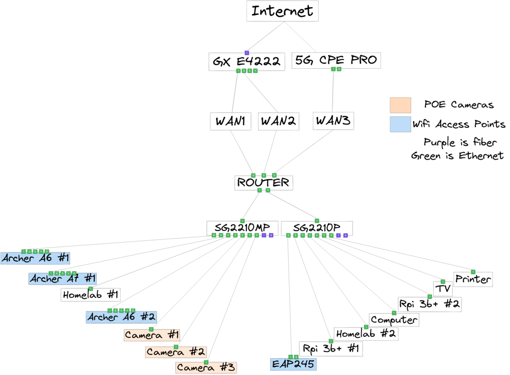

My home network diagram
The tuya Device is connected to Archer A6 #2.

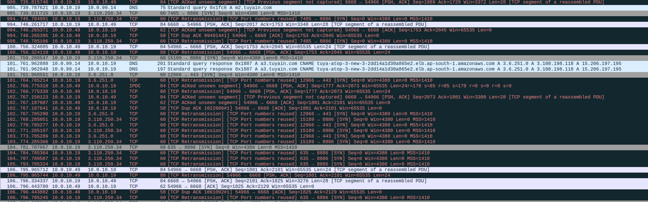

In the packets captured on the router, I see it tries to send the SYN+ACK after masquerading to 10.0.10.19. I am not sure if it’s dropped by any firewall rules? I had tried after disabling all rules and it still didn’t work. This packet will go from Router → SG2210MP → Archer A6 #2 running Openwrt → Tuya device. I ran a packet capture on the Archer A6 and I don’t see any packets coming in.
So far, I have no reason to suspect SG2210MP could be responsible here since in the past I have tried it without involving that switch and I had this problem and I can reach the address 3.6.251.0 or 3.110.250.34 from Archer A6 #2 or any other non-tuya devices down stream from SG2210MP.
I have also tried capturing ALL packets with src/dst address 10.0.10.19 and IP Protocol=ICMP and I did not see any packets except for the echo request/reply packets(because I was testing connection by pinging the device). I tried this thinking maybe it was generating ICMP messages some where? but that was not the case.
