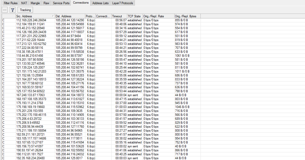

I see in the conntrack table a lot of connection to not-active IPs
they are in conntrack
established
but on the class 185.208.44.xxx there are NOT IP active.
only the router has the first ip of the class, the other are currently unallocated.
why I see them established and inserted in the conntrack ?
thank you
If you take a closer look, you’ll notice several things in common to all those connections:
  • they are incoming ones to the addresses from that range (**dst-**address~“185.208.44”)
  • they show Repl. Bytes 0
  • their Orig. Bytes values are much higher than would be appropriate for the initial SYN packets from a client to a server
  • both their source and destination ports are from the range typically used at client side, i.e. no “well known” ports where servers typically listen
Although a TCP session is not actually established until the initial “three-way handshake” is completed, the connection tracking sets connection-state to established immediately when the initial packet is accepted by /ip firewall filter. So as you say “currently unallocated”, I guess your firewall rules do not drop incoming packets towards 185.208.44.0/24, hence their arrival creates tracked connections in connection tracking.
Since the initial packets are larger than a normal SYN one would be, I’d assume their arrival is caused by some malicious activity. If they weren’t for unallocated addresses, I would think these are hangovers of connections which you terminate on the firewall before they actually end (your reduction of tcp-established-timeout), but that’s clearly not the case here.

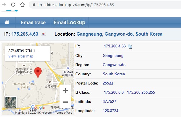

Any connection or business with South Korea from Ravenna Italy?
