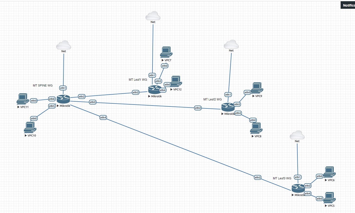

This is my test setup. It is just simple setup with two goals:
.get the wg connectivity running between spine and leaf1 and spine and leaf2. not between leaf1 and leaf2.
.getting correct ip address of the VPC’s on leaf1 and leaf2.
IP addresses:
spine 10.10.100.0/24
leaf1 10.20.100.0/24
leaf2 10.30.100.0/24
wg connectivity is working, as it suppose to.. but.. what i am experiencing is that on the VPC of a leaf1 and leaf2.. when doing DHCP function do NOT GET THE IP address of the leaf itself (10.20.100.x and 10.30.100.x respectively) but the ip address of the spine! Again, no ‘nuclear physics’ mikrotik setup .. pretty simple. Where am i doing/making/‘enabling’ error?
Here is the spine code
# apr/02/2024 10:53:30 by RouterOS 7.9.1

Here is a leaf1 code

and a leaf2 code

??? There is no DHCP in wireguard, its not a regular type of subnet, its really an IP address and an interface.
(1) Allowed IPs on spine are incorrect,
a. you need to put the actual IP assigned to the leaf peer ( and any remote subnets local users are visiting, or any remote subnets visiting your local subnets)
b. you dont put endpoint address or port
(2) Allowed IPs on leaf1 & 2… missing persistent keep alive setting
(3) Allowed IPs on leaf2, incorrect, the endpoint address you put is not based on the spine public IP address ???

  1. so i should put ether2 out of the dhcp server? And should put the ip of the leaf1 (and 2 and 3) in the wg setup..something like this?
/interface wireguard peers
add allowed-address=10.20.100.0/24 endpoint-address=192.168.216.135 (or if the public ip address is dynamic, i put here cloud dns address?) endpoint-port=13299 interface=wireguard1
add allowed-address=10.30.100.0/24 endpoint-address=192.168.216.137 (or if the public ip address is dynamic, i put here cloud dns address?) endpoint-port=13299 interface=wireguard1
add allowed-address=10.40.100.0/24 endpoint-address=192.168.216.138 (or if the public ip address is dynamic, i put here cloud dns address?) endpoint-port=13299 interface=wireguard1
add bridge=bridge1 disabled=yes interface=ether2
add bridge=bridge1 disabled=yes interface=ether3
add bridge=bridge1 disabled=yes interface=ether4
2./interface wireguard peers
add allowed-address=10.10.100.0/24 endpoint-address=192.168.216.137 endpoint-port=13299 interface=wireguard1
  1. Then, what which value/ip address should be instead of the public ip address? the ip of the spine (10.10.100.254)?

Ok…
so according to @anav, spine should be
add allowed-address=10.20.100.0/24,10.30.100.0/24,‘whatever remote ip of the peer the spine should connect to’ endpoint-address=public ip address resp. dyndns(cloud) address of the leaf(s) endpoint-port=13299 interface=wireguard1
and on the leaf side(s)
add allowed-address=‘ip address of the wireguard interface of the spine’ endpoint-address=dyndns address of the spine endpoint-port=13299 interface=wireguard1 persistent-keepalive=25s
are this setting now correct?
