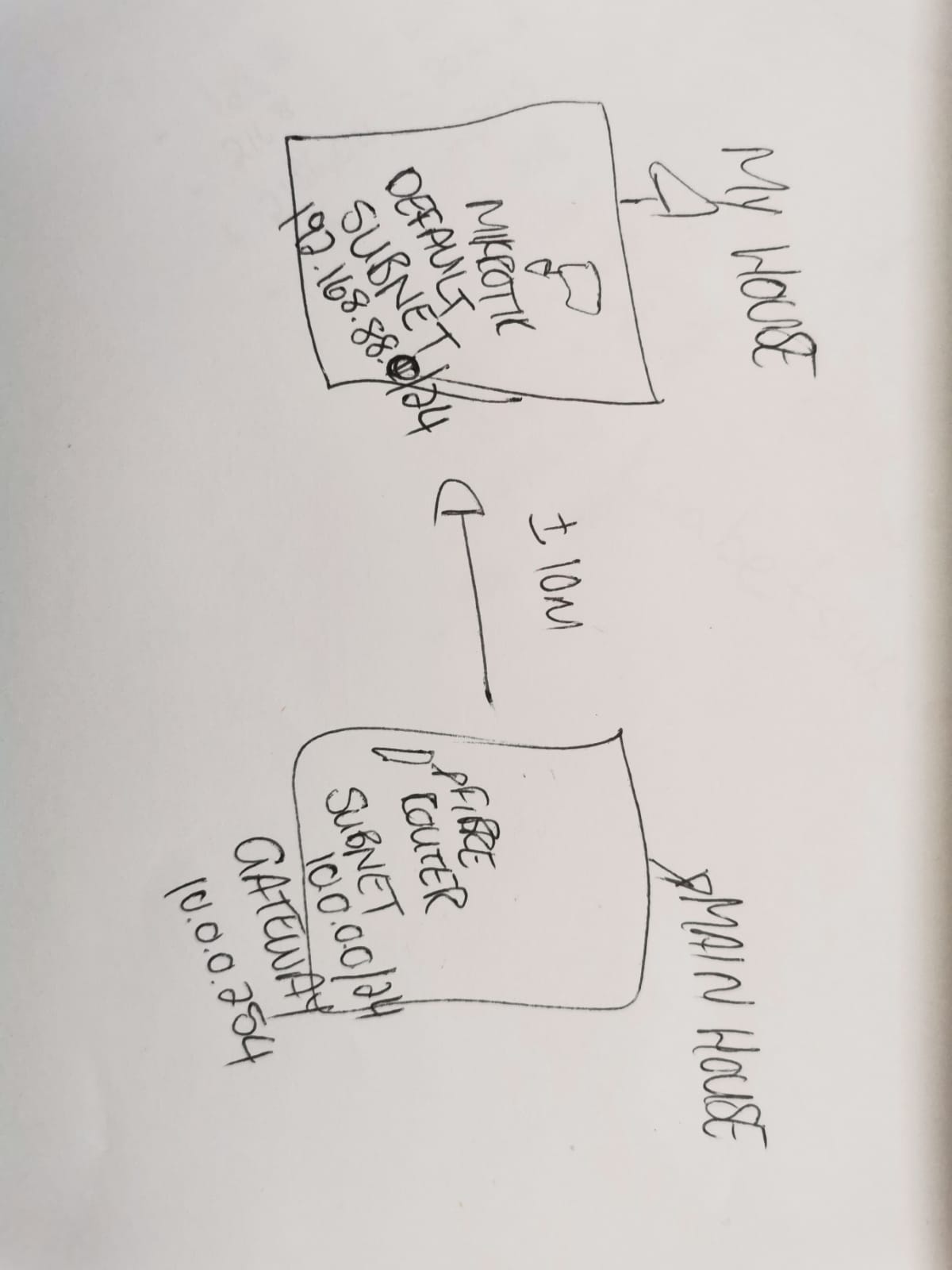

I’m slightly at loss about how exactly your network topology looks like and how exactly is MT configured. So I suggest you to post a chart (hand drawing would do) of your LAN (showing fibre router, mikrotik, typical LAN device, together with types of connections between various devices). And actual configuration of mikrotik (execute command /export hide-sensitive file=anynameyouwish from terminal window, fetch resulting file, open it in text editor and copy-paste it here, inside [__code] [/code] environment).

Sorry for the delayed response. Attached you will see a quick drawing of where the fibre router is and my mikrotik. What I want to achieve is to connect the mikrotik to the fibre router with the wireless interface and from there, the lan interface/s should give out internet to the cable connected devices. I have factory resetted the mikrotik so everything is on default now.
Thanks again in advance.

I’d still like to see actual configuration from your Mikrotik. I don’t kniw (by heart) how exactly default config looks like and thus don’t know what exactky has to be changed to get things working.
So, please, follow the procedure I described to export config and post it here.

If you’re going to use wireless to connect hAP ac2 to ISP router, then decide which band you’re going to use for that … if you have a choice at all (depends what wireless is supported on ISP router). But since there’s some distance between both devices (10m if I see correctly) it’d be better to use 2.4GHz.
