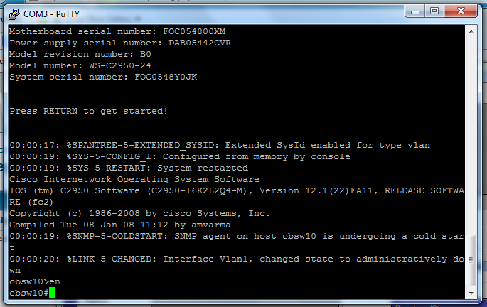

I am using a USB to serial adaptor, but it works fine when I connect to Cisco devices, so I don’t know why I can’t get the Mikrotik to work.

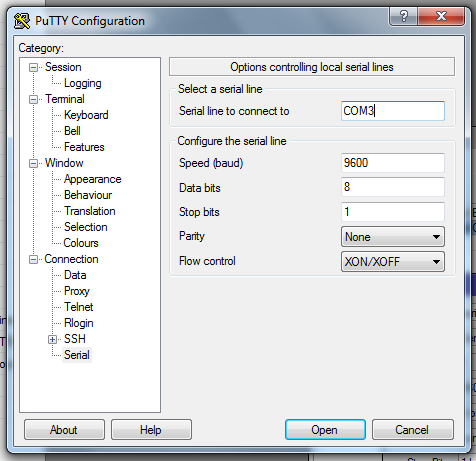

Use this settings on both ends:
Baud: 115200
Data: 8
Parity: none
Stop: 1
Flow: none

I can connect a cisco style roll-over cable to my RB2011, and using the terminal emulator configuration above I can access the serial console on that router without any problems. So that rules out a problem with the serial port on my PC, or my terminal emulator configuration.

Remember COM ports are not dynamic - but work on boot. Thus to make it work you have to connect the cable, use i.e. Putty to start the serial session - and then (important) reboot the Mikrotik RouterBoard to have the device discover and then interact with the serial session.
BTW
Can just confirm that the baud rate has to be 115200 (i.e. 9600 outputs obscured garbage in the terminal window) and that flowcontrol has to set to none.
Thus:
Speed (baud): 115200
Data bits: 8
Stop bits: 1
Parity: none
Flow control: none
