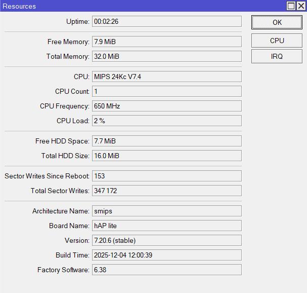

ROS7 will not run with only 32MB of RAM.
Do you have issue with upgrade on the 64MB RAM 16MB Flash devices? Where can the update .npk file be stored on such device?

Can you upgrade to 7.20.6?

I see that the .npk file is only 7MB and small enough for the free storage space, unlike the ones for other architectures. But then MikroTik is wrong in the documentation. Or maybe they write that so that they'll be able to break compatibility anytime in future versions when they add more bloat.
As long as you stay with normal wireless drivers (where applicable) I haven't seen any issue upgrading on those devices. Zero.
For those devices able to use wifiwave2 drivers and only having 16Mb of storage (AC2, cap AC, cap XL AC, wap AC) , that's something else.
There have been a couple where I had to revert to netinstall but certainly not all.

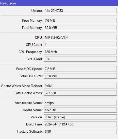

I can confirm that 7.x (I seem to remember I tried 7.14.3) does work on hap Lite, but I can also confirm that compared to to 6.49.19 it "feels" more sluggish, at least in Winbox/terminal interaction.
It was just an experiment, so I cannot confirm the unstable behaviour infabo reported, and - for the particular use I had for that device (plain link in station-pseudobridge mode to get a slow internet connection for updates/upgrades to a couple of devices that are normally operating "air-gapped", so only briefly switched on when doing maintenance) both v6 and v7 worked just fine.
I reverted to v6 only because I have other hap Lites on that same release, to keep all on the same version that would IMHO be more convenient if a swap would be needed.
