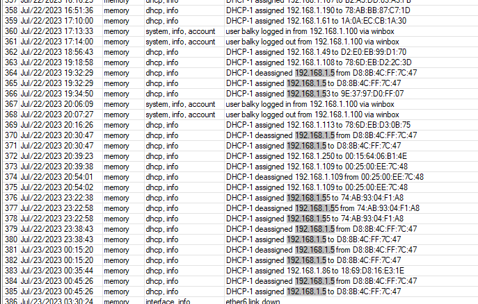

In the log I see a few devices that get their ip addresses Assigned and deassigned constantly.
I am not sure why that happens and where to look for a problem and whether it is the router itelf or there’s a problem with those devices.
The lease is set for 72 hrs.
Where would I need to look for a problem?
Thanks :slight_smile:
I see this kind of behavior with both wireless and wired clients.
Both loose connection and upon reconnect they do a DHCP request. Is this happening?
