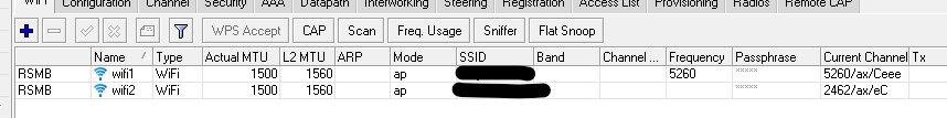

I have a hAP ax^2 connecting to a cAP ax and the distance is about 15 feet apart with direct line of sight. The hAp is on a desk with all ports plugged into devices (comps, Printer) and the cAP is on the ceiling. About 5 times a day the connectivity between the two just drops. I am able to see all MT routers, switches and AP’s on the network thru Winbox broadcasts until the drop, after drop, only the directly connected hAP.

Here are settings on both hAP and cAP ax
hAP:
cAP:
