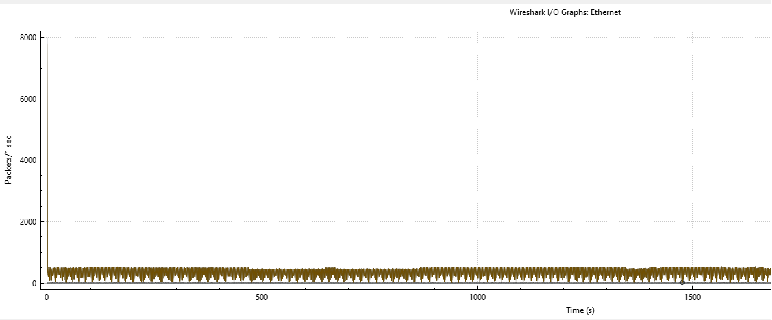

Attached is a graph of the number of packets per second - for the entirety of this graph neither the Mikrotik nor my laptop are connected to the internet, this is all traffic between the Mikrotik and the laptop and in fact has the Wireshark filter of “ip.addr == LAPTOPIP && ip.addr == ROUTERIP” so this is only traffic between the two devices.
EDIT: The traffic is mostly going from the Mikrotik to my computer

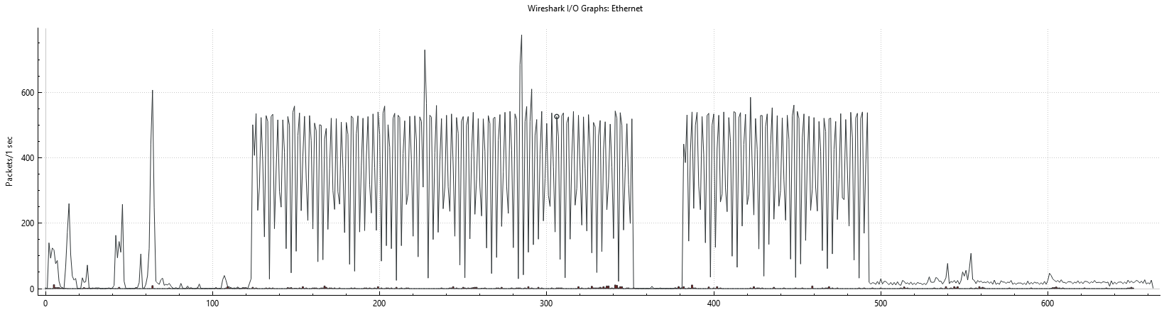

Just to add, a few minutes after submitting the post it seems to have stopped (look around time 500 in the attached) - even though WinBox is still open and I didn’t change any settings
I have the PCAP from when it was transmitting constantly so if anyone has advice on how to try and figure out what was being transmitted please let me know.

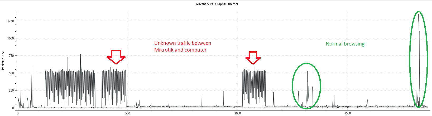

Just to add what the Wireshark graph looks like with normal light browsing (green) and that compared to what I raised as the question of this post - constant 500 packets / second traffic from my Mikrotik to my computer

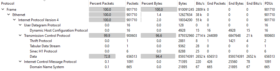

The protocol distribution is as attached. This is after filtering as ip.addr == MIKROTIK and ip.addr == LAPTOP so it’s only traffic between the two devices (and I confirmed it’s all on WinBox port by looking at the TCP tab of Conversations which shows the conversations by port)
It’s odd to see these but then maybe it’s just WireShark not decoding the packets properly (I had asked about something similar previously, see thread here: https://ask.wireshark.org/question/33535/why-is-mikrotik-router-using-drda-protocol/)
Thrift
Tabular Data Stream
Sinec H1 Protocol
Most of the ICMP traffic is related to DNS and is the Mikrotik telling my computer that the destination is unreachable (which is not surprising given the Mikrotik was not connected to the internet during this capture). Within ICMP, the DNS queries are for URLs I’m familiar with (they relate to my antivirus, operating system upgrades, etc). Of the ICMP that does not relate to DNS, it’s for IP addresses that belong to my antivirus provider.
The ICMP traffic does not look odd to me but I do want to better understand the TCP traffic
