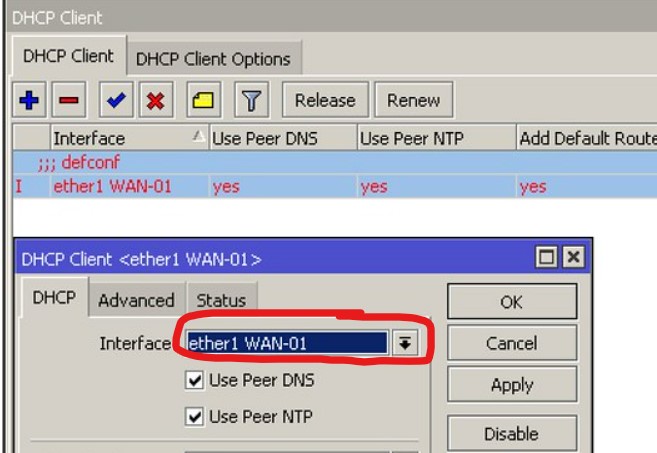

Part by part:
This is good…???
Active ether1 WAN-01 ??? in DHCP Client?
aa by P. Ramiro, en Flickr
ab by P. Ramiro, en Flickr
ac by P. Ramiro, en Flickr
ad by P. Ramiro, en Flickr
Gracias.
Set DHCP client on the bridge (it is RED now because it is not correct!) or just disable it or remove it.
You can work without DHCP client if your DNS, NTP and IP route is set correctly.

It must not be correct because it does not work for me, I have put DHCP client and removed everything you have told me and it works.
NOTE: I am now studying the NTP, thank you.
IMPORTANT
I think solved.
THANK YOU VERY MUCH bpwl
The configuration was gone, it followed its indications from a year ago, point by point, but one is missing from the list:
Use a DHCP client on the bridge.
