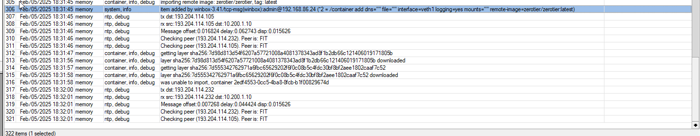

I’m having issues when trying to run the ZeroTier container in my environment.
Currently, I’m running a CHR on VMware ESXi 8.0 Update 2, and I installed the CHR by downloading the OVA file from the official MikroTik website.
When I try to deploy the container, I get a generic error, which I’ve attached a screenshot of.
Does anyone know how I can resolve this issue?
Thank you!
2025-02-05 18_32_30-admin@10.200.1.10 (MikroTik) - WinBox (64bit) v7.13.5 on CHR (x86_64).png

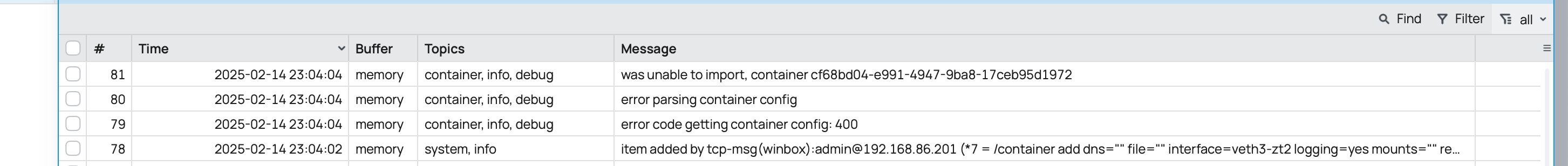

Anyone Does anyone have any updates regarding this issue? I’m adding another screenshot of the error from the logs to the post.
