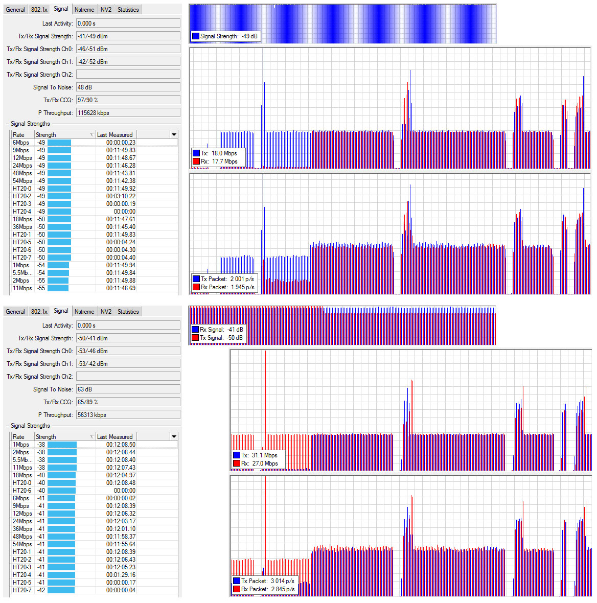

I’m experiencing frequent interruptions of the traffic. They last 3-4 seconds and happen often, sometimes several times a minute, sometimes once every couple of minutes.
The traffic comes from the Server PC connected to the Switch.
But I also ran the Bandwidth Test in Winbox and the result is the same, so it’s definitely the wireless connection.
I tried many settings already.

I experienced the same problem, but with an entire capsman network across my corp’ open spaces, and like you i played with many parameter but not able to find the thing to tweak to stop these interruption/data loss/big latency.
It could be nice if mikrotik provide some input.
3 Years later, the same problem.
Short interruptions in 2.4 GHz, 5 GHz is working continuously.
