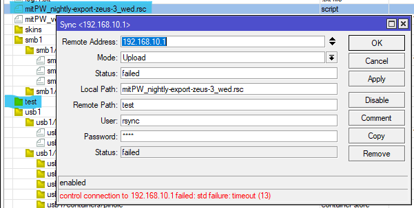

But again, it doesn't work. What has to be done to make it run? FW? ipsec? soemthing else?
The MT docs says: " Port TCP/8291 is used for the control connection (if not open in the status (file sync print) you will be stuck at making control connection to YOUR_IP)"
Hence, it is maybe FW, but I opened TCP/8291 already and should it be always open between 192.168.10.1 and 192.168.10.1 = between myself?
Tried it with 127.0.0.1 instead of 192.168.10.1 as well - with no success
If this works, it will be probably easy to change it for the original question with SMB and USB

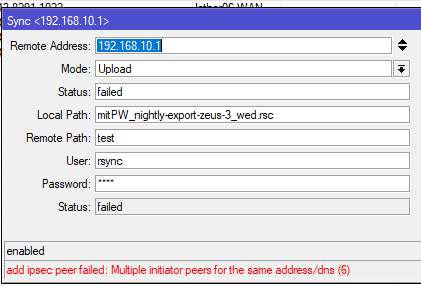

UPDATE: just added this FW rule (with counted packages)
grafik
and get now
what could be the next to avoid this new error?
