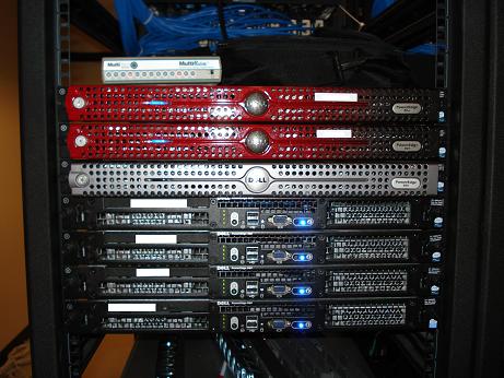

We’re in the middle of a new build out now; I’ll post some pictures of our MikroTiks when everything is online. One of the guys took the ugly plastic Dell bezel and gave them a red fading to black paint job more appropriate to a firewall.

We have two firewall/routers, both Dell PowerEdge 860’s with Dual-core Xeon CPUs. The one serves our busines network, the other services our wired and wireless guest network running hotspot. There’s a third identical cold spare mounted below. Move the flash card and network cables, then hit power button. If the flash is bad, we have an extra flash with the same version of ROS to dump a backup or export onto from either of the primarys.

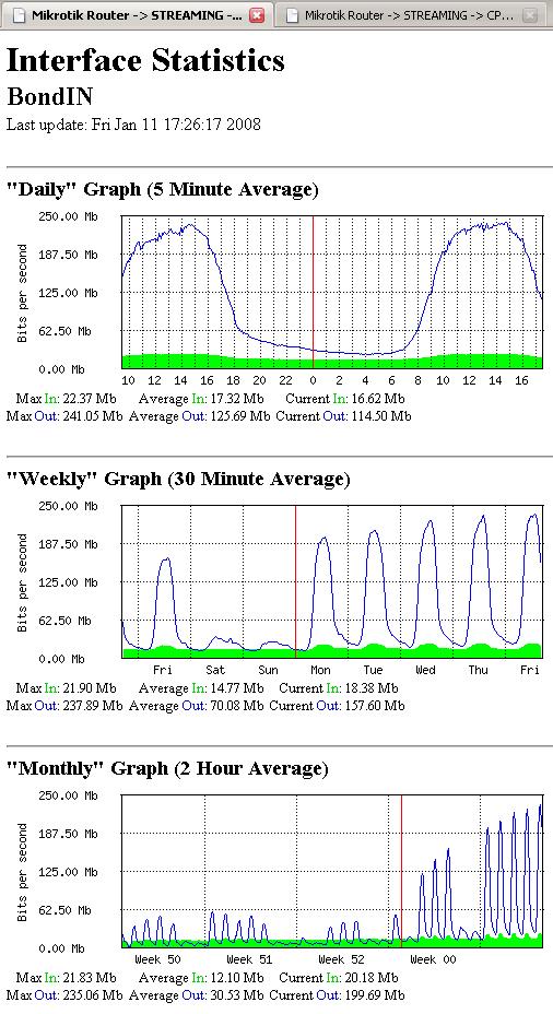

Our streaming went also live on the 1st, there’s an HP DL140 on it built as a transparent bridge. Today it hit 200Mbs+ outgoing / 20mbs incoming on the outside bonded interfaces for several hours. It’s still 2.x; so we’re watching it closely as it only sees a single CPU.

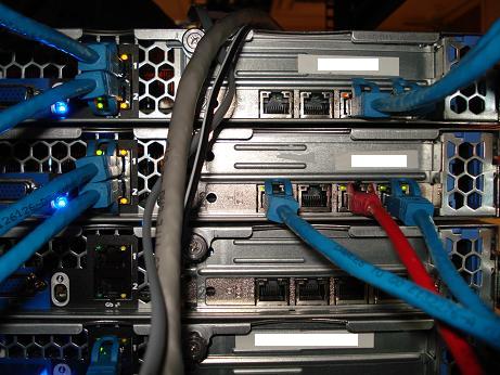

Some install pictures.
Look nice. On thing, all the ethernets are in the back! Thats the hardest thing to fix too!
In this install all of the racks are prewired with a 48port Cat6 patch panel to central wire management racks. All switching is located in the wire management racks. The patch panel is mounted at the very top, rear of the rack; so the rear Ethernet is suited for this type of install. You can almost see it in the top picture behind the modem sitting on the top unit. This room has 10 racks for equipment and then 4 wider racks with additional wire management space that houses the main patch panels, fiber patch panels to IDFs, switching, other routers, etc..

This graph is from an HP DL140 that’s serves our streaming.
It went live the 1st of the year.
