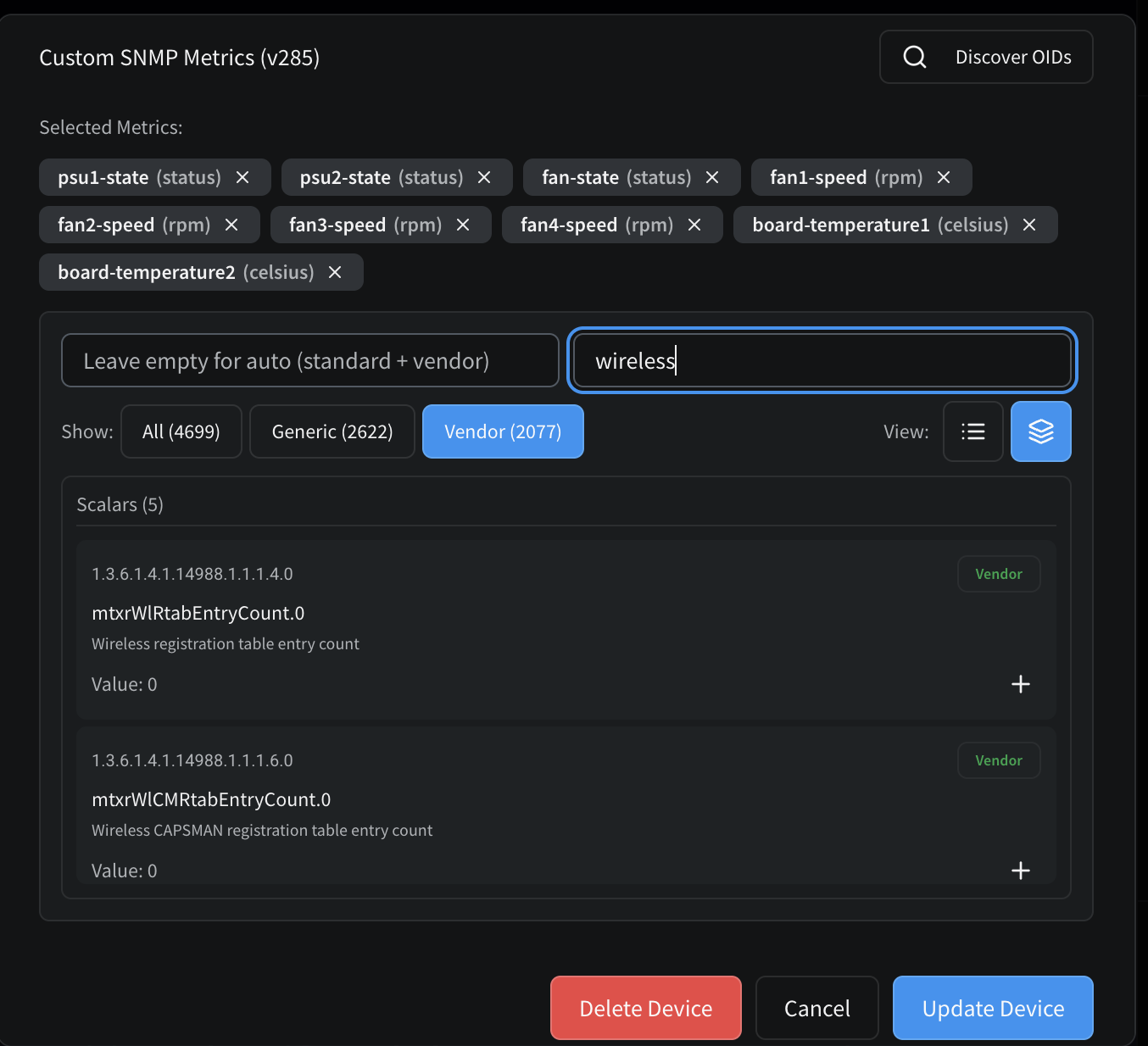

I have just published build 301, which has some support for using MIB files.
Please test it with you mib.

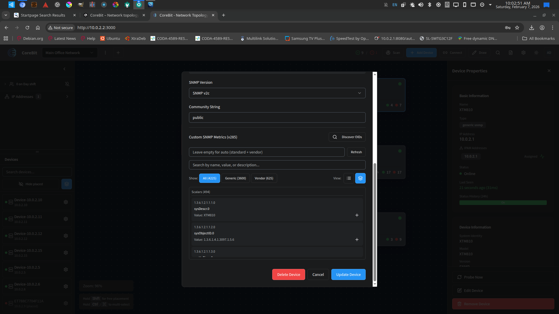

Go to settings and upload the MIB file.
On the device, change it to custom credentials, add the SNMP credentials, select your mib, press discover.
You can do that in latest build.

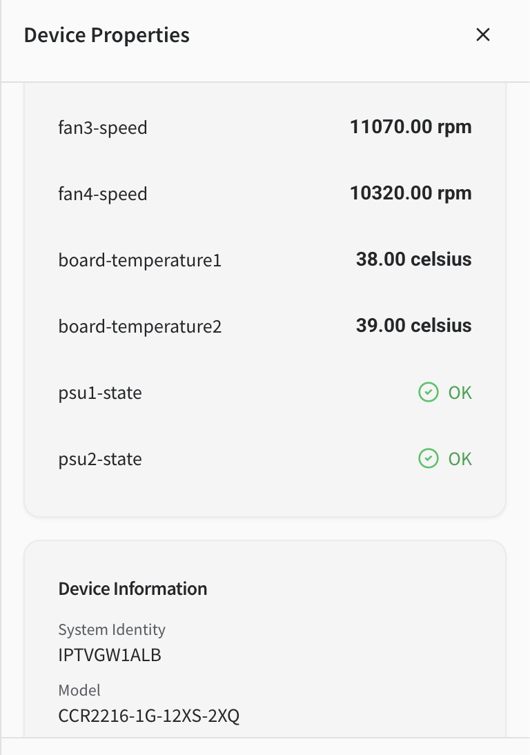

That way you can add any metric to the device like this:
And see them here.

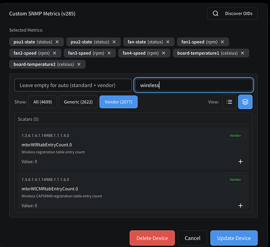

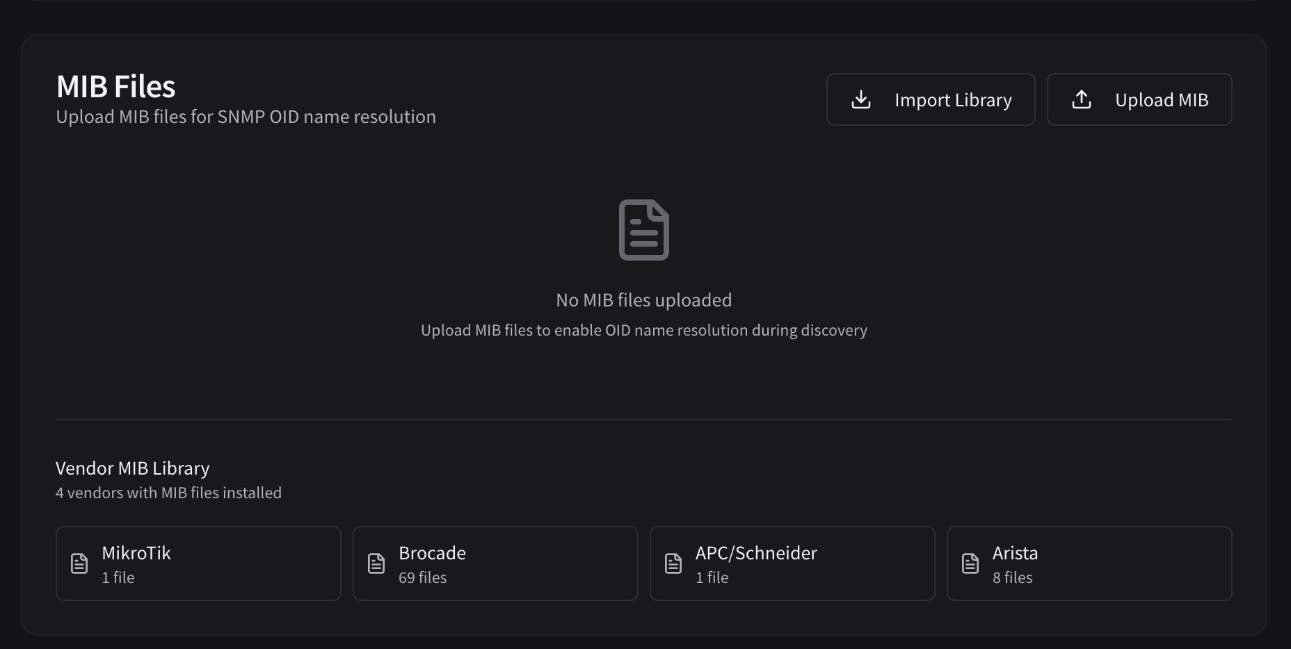

I have totally revamped the custom SNMP function.
It is now possible to both import mibs, and upload own.

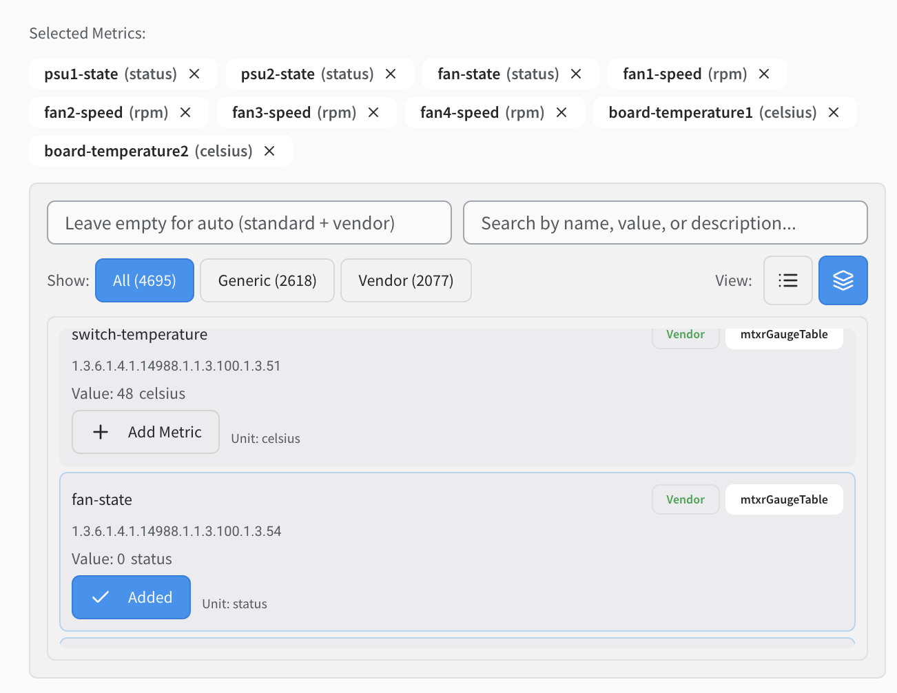

When discovering OID’s it will autodetect the device MIB if possible.
If matched, it will present SNMP Metrics like this:

Docker corebit build 322

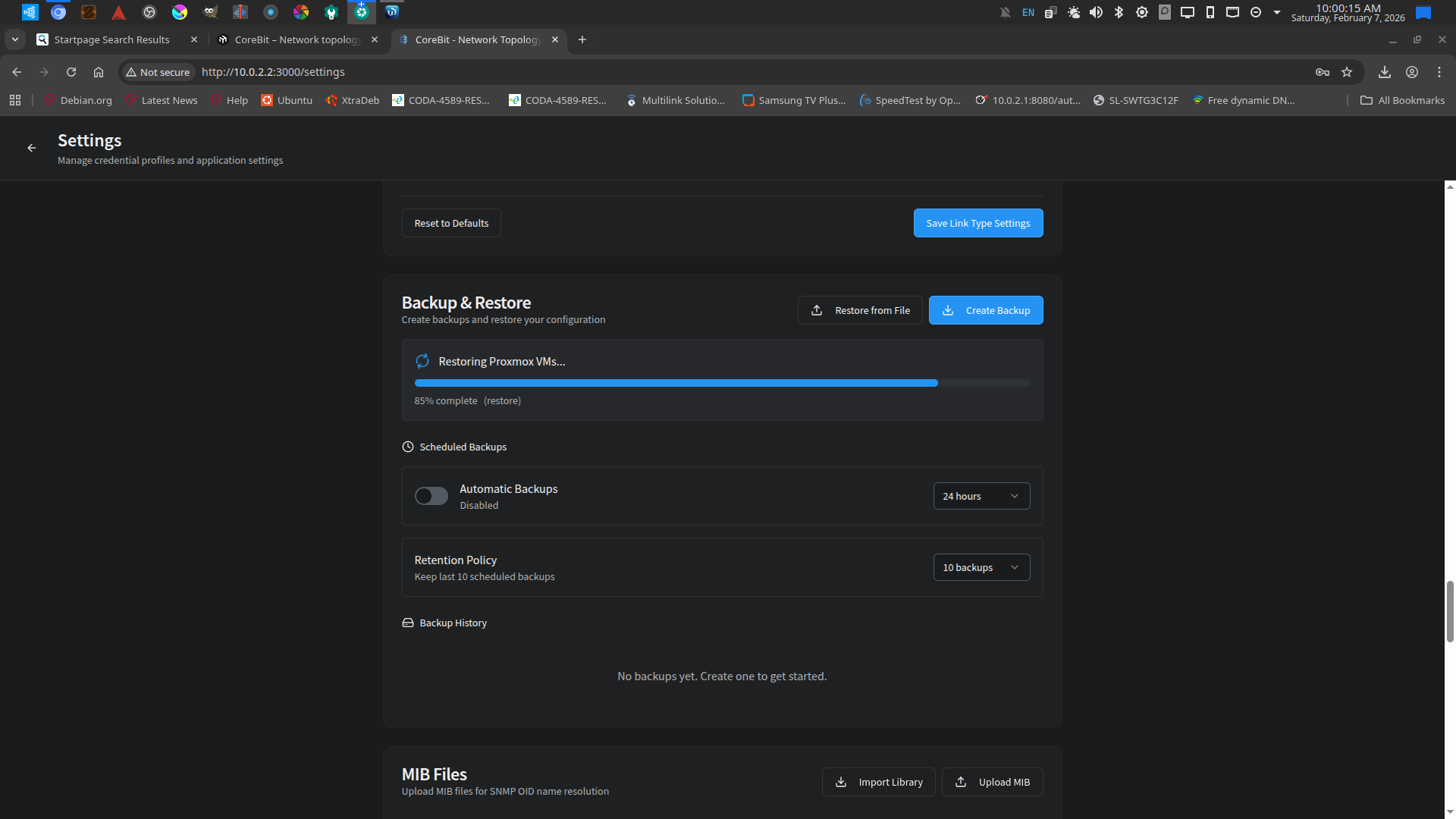

When I do a restore is stops at 85%
When I do a Custom SNMP. I’m still getting the older version.
I also see in the logs;
[MibCache] Vendor index not found at /app/data/mibs/vendors/vendor-index.json
