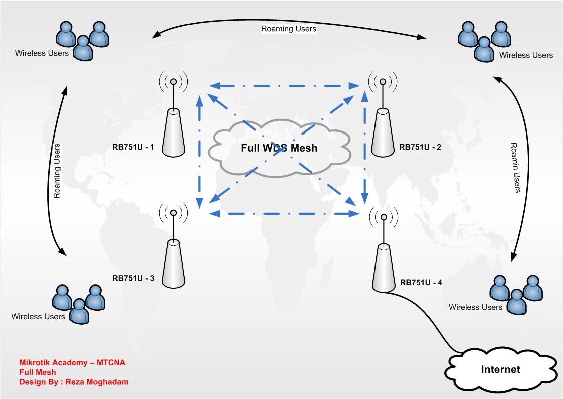

For your first problem I think that a screenshot can better help us to understand what you have already done before to find what’s wrong.
But if I understood you try to build a Roaming Users…
So try setting of Reza Moghadam
http://wiki.mikrotik.com/wiki/Wireless_WDS_Mesh
