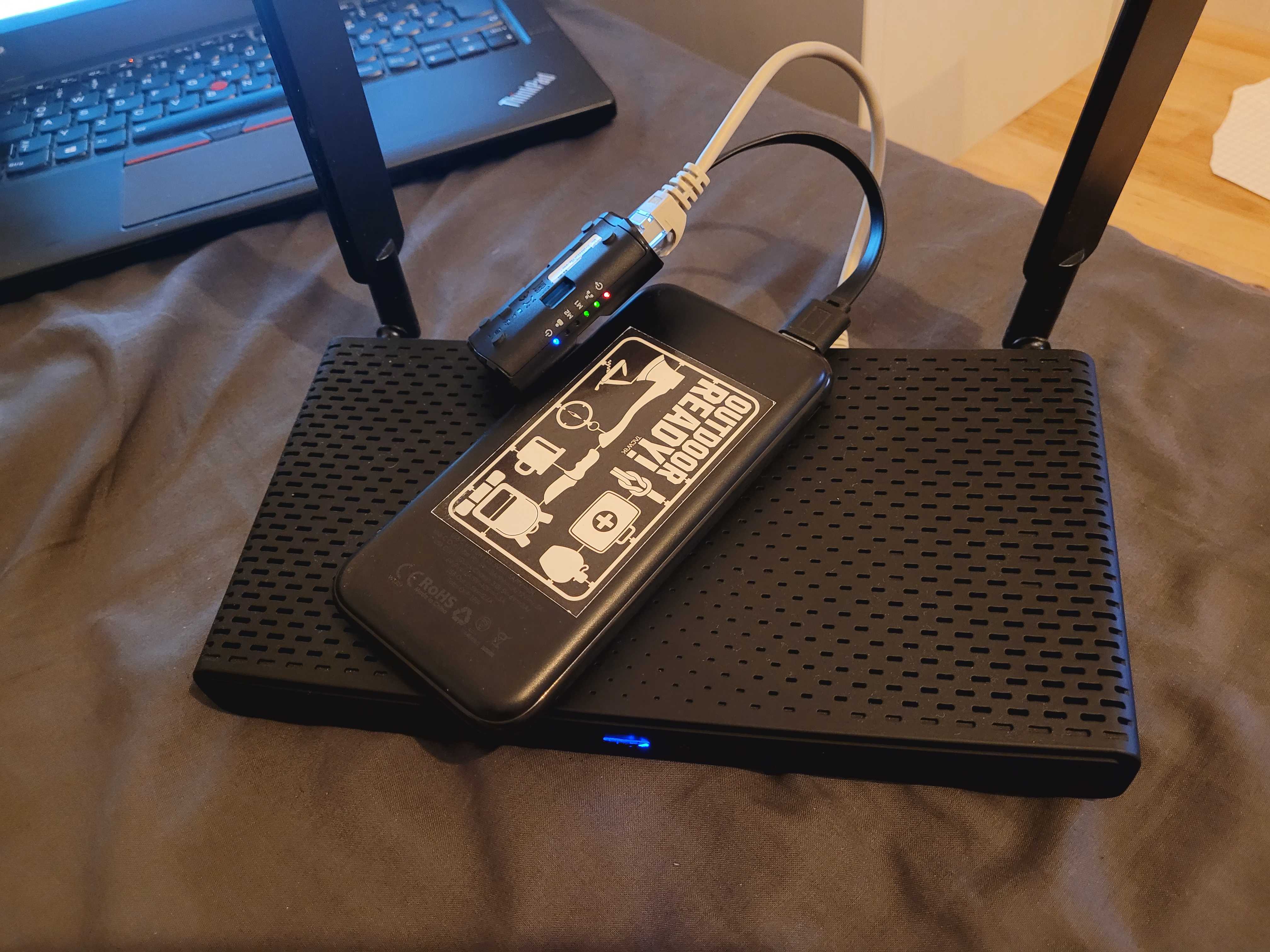

Proof of concept, with a hap ac3:
@drasir
what’s the capacity of that powerbank and how long can you run that ac3 on it ?
Normal use of the device with some clients, I assume ?
Just hooked it up to check for myself.. It’s a 10000mAh one from Aukey.
hap ac3 is replaced by rb5009UPr for me, so it is not on active duty. (And is bootlooping right now, might need some netinstall, so i can’t test it right now)

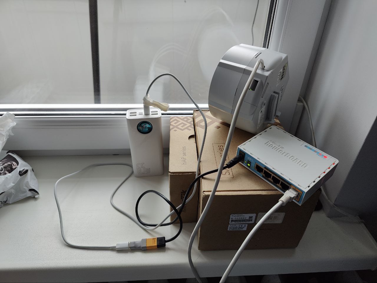

PowerBank with PD output (20V in my case) + PD 20V trigger ( https://www.aliexpress.com/item/1005003160923563.html ) + XT60 connector + XT60 to 5.5x 2.4 cable (from Miniware TS80 Soldering ha-ha [yeah, it’s not 5.5x 2.1 but it works]) + a little bit of soldering.
But now, it’s easier https://www.aliexpress.com/item/1005003380656890.html - Mikrotik uses 5.5 x 2.1.
