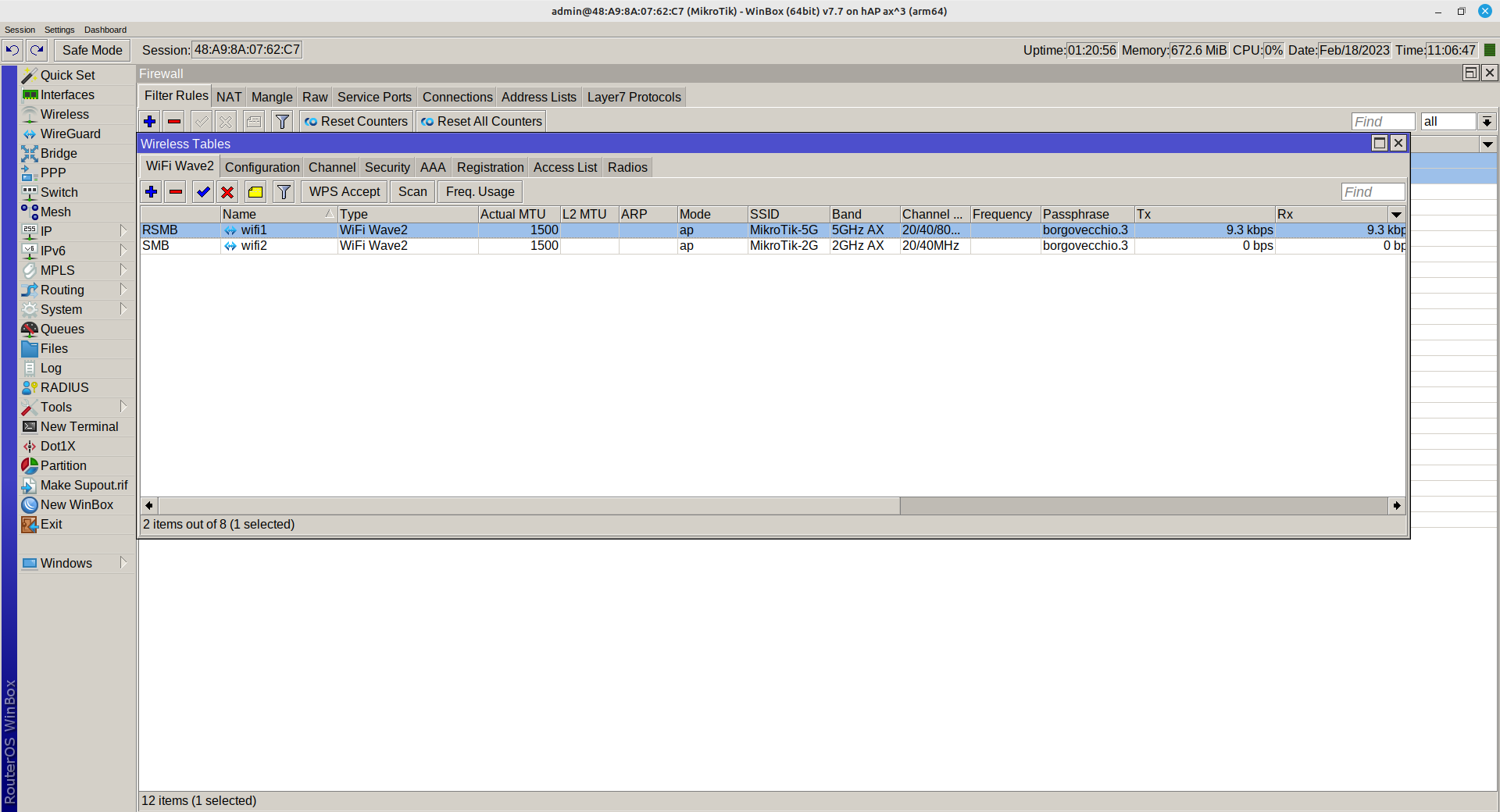

Hello, I beg your pardon for my worst English but I’m trying to setup my new xap ax^3 as an access repeater but I cannot follow the suggested guide because I don’t see the “Setup repeater botton” either in winbox or by http access.
Also all the wireless configuration is pretty different compared to the documentation I’ve found on line (es: https://mikrotrik.com/how-to-setup-mikrotik-wifi-router-as-repeater-mode).
Could someone please help me ? where is my mistake ?
Ps. I’ve upgrade the routerOs to the latest version avaiable 7.7

Newest Mikrotik wireless devices (i.e. any model with “ax” in name) use new wireless driver (wifiwave2). This dtiver lacks a few functionalities, one is mode support limited to ap and station. So it do4sn’t support any of *bridge modes, needed for repeater mode.
So in short: ax devices can’t be configured as repeaters (yet).
