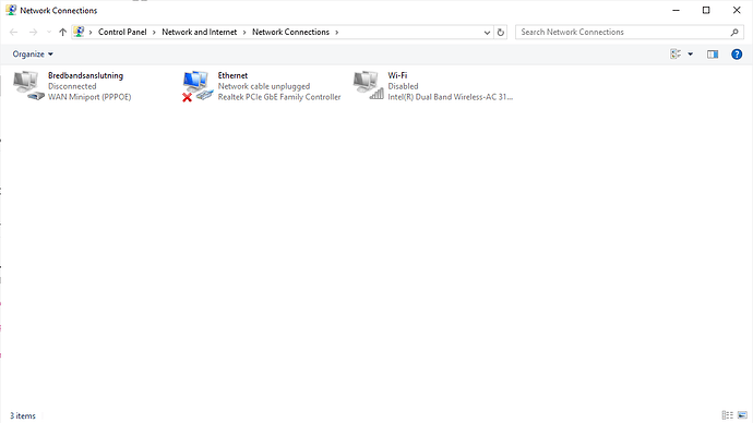

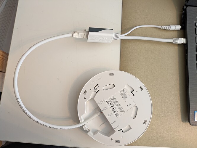

I’m running Netinstall (version 7.19.2) on an laptop with Windows 10 Pro installed. Windows Defender Firewall is disabled completly. I’m planning to connect my laptop with the AP unit directly through an ethernet injector.
Note that I’ve disconnected the AP from my laptop and power socket before going through the tutorial.
I’ve disabled the other two network interfaces in Windows, as instructed in the tutorial.

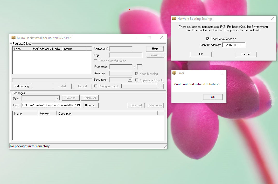

The tutorial doesn’t mention any “Could not find network interface” windows. Note that I still haven’t connected the unit to either a power source or the laptop; the tutorial says that it’s the next step.

What do they mean with “[m]ake sure that the Ethernet interface is running”? It’s active, but because I don’t have any ethernet cables connected it says it’s disconnected. This must be correct?

Try version 7.18.1 and stick for now with wireless package.

Sometimes it takes multiples tries. Press reset, THEN apply power and keep pressing reset until you see the device appearing.
Putting a stupid dumb switch in between can sometimes also help.
Thank you! This solved my problem. What did they do that made it impossible to update their firmware?

Found this thread while googling, joined to say it was netinstall 7.20 beta 9 that worked for me on win11.
Stable 32/64 didn't work for me with “Could not find network interface” when trying to create the netboot server.

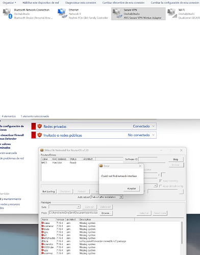

I have a crs309-1g-8s+in that turned off when it was updated. I'm trying to reinstall with netinstall in Win 11 version 7.20 but it won't let me. That message appears. If you have any ideas, it would be a big help to recover the new switch
Generally speaking there are two main issues with modern PC's and modern Operating Systems:
  1. multiple interfaces (ethernet/wifi/virtual)
  2. firewall
You can temporarily disable ALL network interfaces BUT the ethernet one you use to connect to the Mikrotik.
The Mikrotik should be ONLY connected to your PC, at which point you can disable, again temporarily, the Windows firewall.
The poster before you reported success with 7.20 beta 9, maybe you can try with that same version.

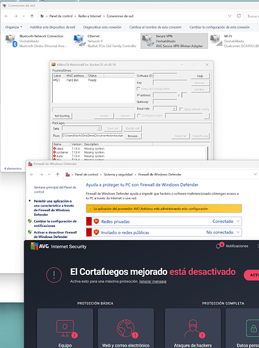

Thank you very much for your suggestion. I checked and applied both of them, but still no results.

After several attempts, I managed to get it to work for me. It worked with NetInstall 6.48 connected directly to a PC CRS and using Jaclaz and Erlinden's advice.
