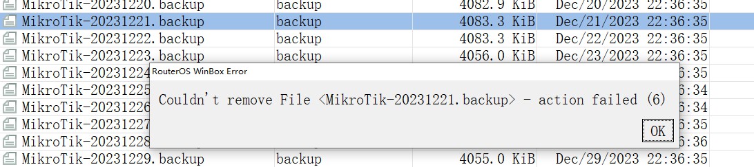

I set a script to backup my router config and send them to my email everyday
everything was fine until 2023/11/02
logs says action failed .
so I try to delete some backuop files via winbox .comes result is [Could’nt remove file action failed]
AND I can’t upload a single file .
since its my primary router So I MUST do everything careful
now ,what can I do except reset config
