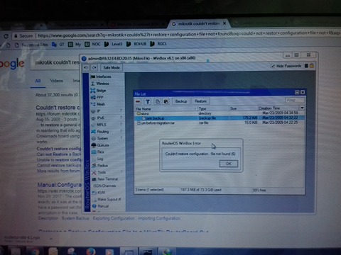

I am also faces of this problem please check attach file
