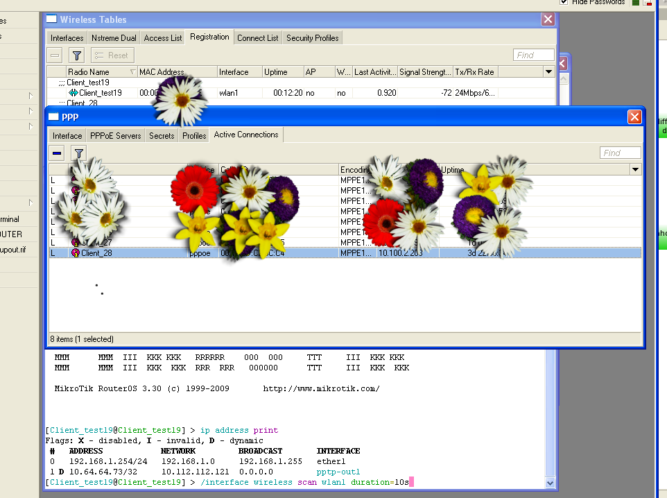

Another Q is should pptp connection be displayed in the ppp active connections, see picture
as Client_test19 which i was using at test is missing from ppp active list but reappears when i select pppoe ?
