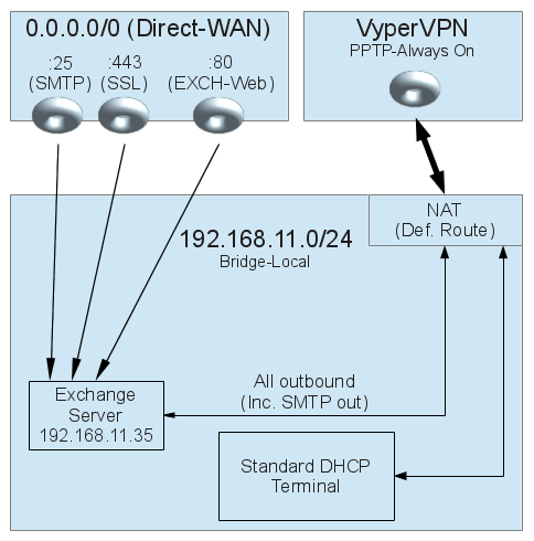

In the attached picture everything is working except for the inbound traffic on three ports from the local-wan connection. All outbound traffic is being nat’d out the vpn just fine and is going very fast. I’ve even got a few routes setup to route nntp and WoW(Game) out the local interface instead of the VPN. All very nice. But Since installing Microtik/RouterOS I’ve been unable to get any packets to route inbound as desired. I’ve previously configured a Buffalo, Linksys, and ISA servers all with relative ease so I know I’m not crazy…
I’m not including current nat/firewall rules on purpose as it’s a mess of rules (mostly disabled) from attempts to route the ports. With exception to vpn default routes the disabled rules mean router is mostly default. I’ve tried just about every method to NAT traffic from sfp1-gateway not from 192.168.11.0/24 on port 25 to 192.168.11.35 (Exchange Server). I’ve even setup up rules to output log before accepting and dst-nating the traffic. The packet counts go up and the log shows data entering the router. But the server never sees it. My only conclusion at this point is that the PPTP vpn connection may be adding extra bolts needing turning to make this work, but I’m unsure.
I suspect that to get any kind of reasonable answer, you will need to post the output of /ip firewall, /ip route, /ip address etc.. Can you not just edit out your disabled rules??
