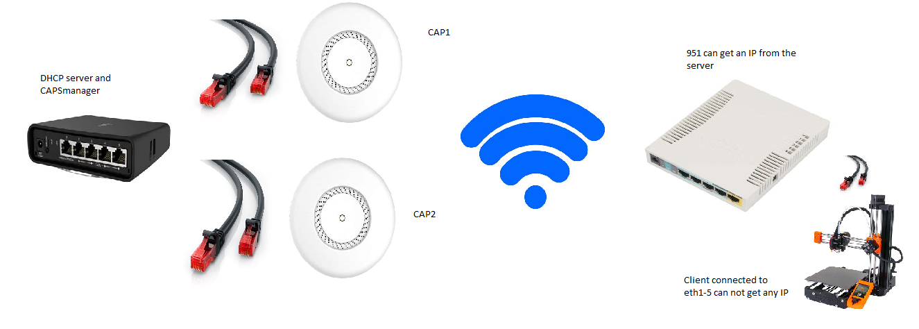

See image below for my setup.
The issue is the clients connecting over the 951 is not getting any IP from the DHCP server, the logs show this:
defconf offering lease 192.168.88.82 for 10:9C:70:0E:04:1B to 4C:5E:0C:39:D0:39 without success

Any suggestion to what I might be doing wrong here?
Anyone? Is there anything that is unclear in my setup or question that I can clerify?

Hmm, so after testing, some I set it up as a PTP Brdige CPE (quick set) connecected it to the wifi and tested by hooking up my computer to eth2.
Behold and my computer gets an IP, I have access to my home network servers and so on (yes I disabled the wifi on the computer).
I disconnect the computer and connect the 3d printer and I’m back with the same issue as before, it can not get an IP from the DHCP server:
	defconf offering lease 192.168.88.36 for 10:9C:70:0E:04:1B to 4C:5E:0C:39:D0:39 without success
So it seems now to be an issue between the printer and mikrotik and not the implementation itself?

The printer was connected over wifi, and got an IP from the DHCP that way. But the wifi is slow and unstable now that the printer is moved in to the closet. So the idea was to improve the built in ESP01 by connecting it over and 951 I had over from earlier days…
Well turning the “always broadcast” option did not help, same error in the logs as before. I will try to connect it directly somehow, just need to figure out how.
Well I setup a DHCP on the 951 and the printer directly got an IP, so I decided to test to give it an IP in the same range as on my main network, 192.168.88.0/24 and now I can access it as I would expect. I would still love to solve my little problem, so I can manage all the configuration on the HAP, but for now I think I will focus on other problems unless someone has a great sugestion to what might fix the issue?
