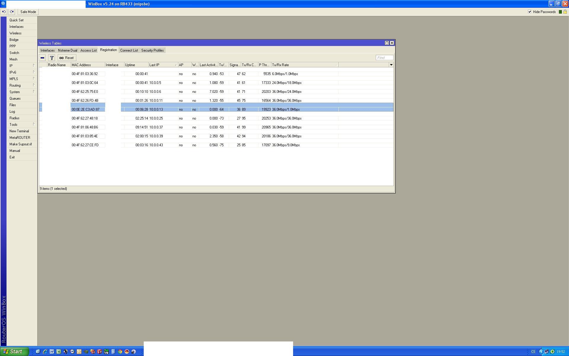

Hello all,
I have problem with disconnecting of my clients. See the print screen.
I have following setup:
AP 2,4GHz: 433 + R52Hn + 3m pigtail + 15dBi omni – 12dbm TX power
Clients: Airlive WL-5460APv2 + 3m pigtail with Jirous panel 9dbi – 8dbm TX power
10 clients with distance from 50 to 250m.
I have tested 435G with the same result.
Any good advice will help me.
Thanks a lot.
Jan

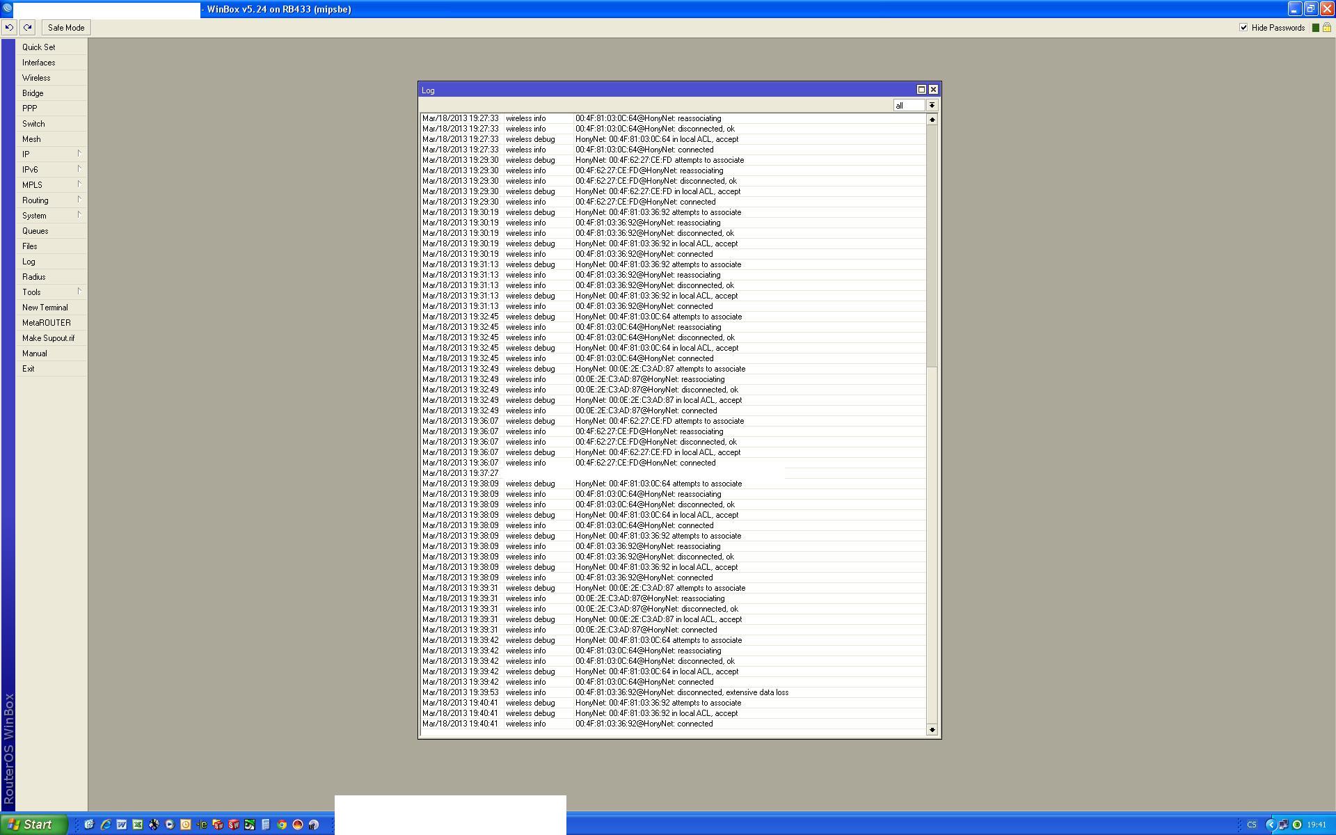

seems like client ask to reconnect. Try to post the client log.
Stone
March 23, 2013, 7:01am
3
Hello Samsung172,
This shows log from CPE unit:
3day 12:49:56 (none) kern.warn klogd: wlan0: Roaming…
3day 12:49:57 (none) kern.warn klogd: wlan0: Associate to AP successfully - 00:0C:XX:XX:XX:XX
3day 12:50:02 (none) kern.warn klogd: wlan0: Roaming…
3day 12:50:03 (none) kern.warn klogd: wlan0: Associate to AP successfully - 00:0C:XX:XX:XX:XX
3day 12:56:39 (none) kern.warn klogd: wlan0: Roaming…
3day 12:56:40 (none) kern.warn klogd: wlan0: Associate to AP successfully - 00:0C:XX:XX:XX:XX
Jan
Stone
March 27, 2013, 7:56pm
4
Log on CPE unit shows this:
Mar 27 03:50:00 (none) kern.warn klogd: wlan0: Roaming…
Mar 27 03:50:00 (none) kern.warn klogd: wlan0: Associate to AP successfully - D4:CA:XX:XX:XX:XX
Mar 27 03:50:06 (none) kern.warn klogd: wlan0: Roaming…
Mar 27 03:50:06 (none) kern.warn klogd: wlan0: Associate to AP successfully - D4:CA:XX:XX:XX:XX
Mar 27 03:50:12 (none) kern.warn klogd: wlan0: Roaming…
Mar 27 03:50:12 (none) kern.warn klogd: wlan0: Associate to AP successfully - D4:CA:XX:XX:XX:XX
Mar 27 03:50:18 (none) kern.warn klogd: wlan0: Roaming…
Mar 27 03:50:18 (none) kern.warn klogd: wlan0: Associate to AP successfully - D4:CA:XX:XX:XX:XX
