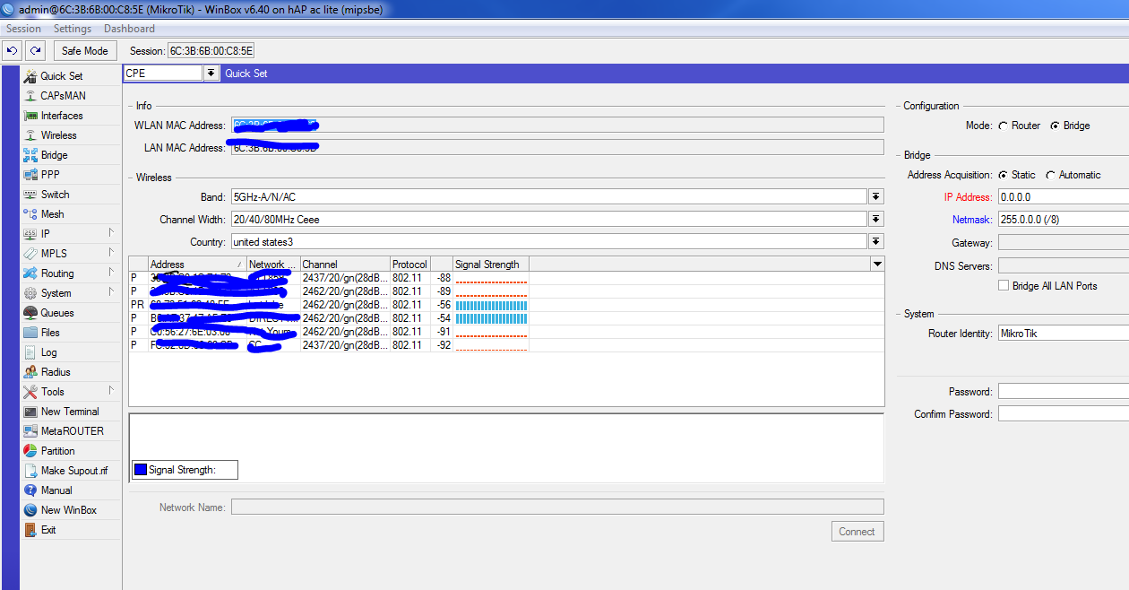

I was looking closely and realized that the WinBox QuckSet screen showed that the Wireless band was set to one of the 5Ghz settings. I clicked on the drop-down and none of the available settings were 2.4Ghz. Weird, but okay. I moved one of the APs I was testing against to 5Ghz and got another surprise. The 5Ghz AP wasn’t listed. My laptop sees it just fine, bit the hAP does not.
It appears that it’s trying to connect to the 5Ghz band, but it is scanning the 2.4Ghz band. ?!?!?!?!
(Image attached)
I guess this explains why it works on the Groove, it’s a single-band radio.
So, I think I’ve found a bug in RouterOS.
Do you guys agree, or is there another explanation?

I have exactly the same issue with my Mikrotik hAP ac (software v.6.40.1) - in Quick Set CPE only 5GHz band is available, while in list shows only 2GHz networks.
I have also tried to disable 5GHz (wlan2 in my case) - nothing changed.
From my point of view it’s a bug. What are the steps to raise it up?

You cannot change the hAP ac lite to a CPE on one radio using the Quick Set page. Do not use the Quick Set page for any settings if you want to have one radio set as a CPE and the other as an AP.
Below are the basic steps needed to set one radio as a CPE. I would use Winbox to make the changes. Substitute wlan2 for wlan1 if you want wlan2 to be CPE. These steps worked on v6.40.1. The should work on earlier version but there may be some Firewall Rules that need to be changed.
