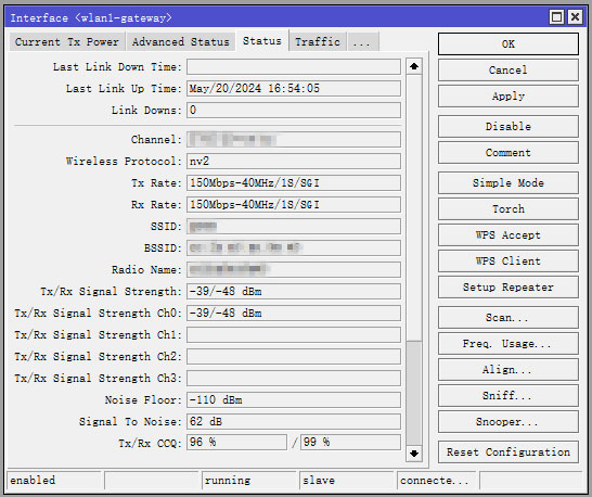

  1. The 5SHPn have the 100Mbps Lan port hardware limit.
  2. Set to bridge NV2 mode? and allows for high-speed connections.
  3. Set the wireless channel width up to 40/80MHz bandwide mode .
  4. Check the channel for interference.

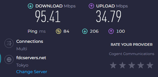

The mode and channel bandwidth used are important. I built the MikroTik bridge speed measurement as shown in the figure.
