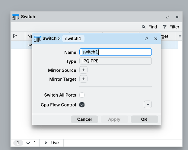

Just checked on a cAP AX, when set (either yes or no) it is visible in the export. When unsetting, it is not shown in the export (obviously). Which makes me think there is no default value.

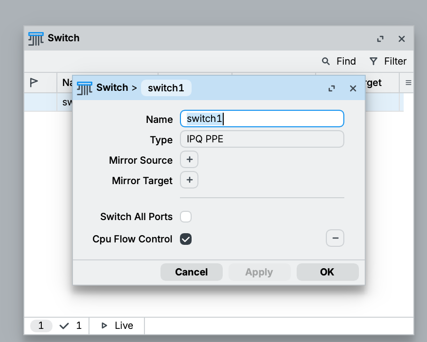

WebUI also shows the parameter (7.21.5 LTS)
Does that mean the cAPax supports CPU flow control?
If so, does that make sense when it’s operating as an AP?
