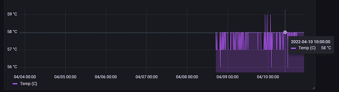

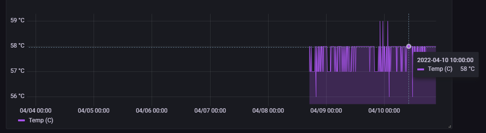

I just got a CCR2216-1G-12XS-2XQ up and running in my lab. I noticed the CPU temperature has been around 58-60 degrees Celsius. Based on the data sheet, it looks like that is on the boarder of upper-end of the operating temperature.
I was curious if anyone else has a CCR2216 or 2116 and is seeing the same cpu temps. Ambient temperature is 20 Celsius.
operating temperature on datasheet refers to ambient temperature suitable for operation
Ah, thank you. So there isn’t any concern that the cpu is around 60 Celsius.
i think for any modern CPU 60 C° its ok
normally in a MikroTik router we dont see CPU deep sleeping on the CPU when not loaded to achieve low temps when the load is low so this temperature is normal even when not heavy loaded
We will see with a heavy workload how much it rise
Looking the images of the thermal solution on ccr2216 i dont expect to have temperature problems
Here’s what the temps are on the two CCR2216s I have in my lab
