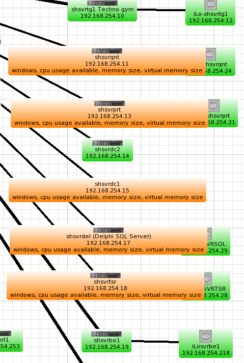

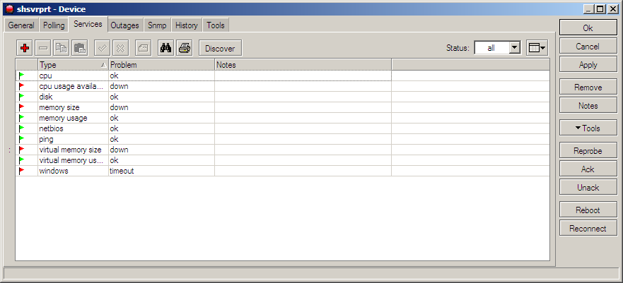

I am having a problem with our Dude system, which is quite self explanatory in the screenshots below! From time to time some servers start showing services like CPU Usage and Memory Size as being down. Well, I can see that The Dude is unable to probe those services so that obviously is “down”. But I cannot figure out why this suddenly happens and normally it is for a number of servers at the same time, like what you can see below. SNMP is configured for every server in the same way.
I searched for this problem but no one else seems to have had problems like this as I couldn’t find anything! I’m kind of a newbie to The Dude, so your help is much appreciated!
Please let me know if you need any other information.

You can find people saying “no mater how many times I re-probe the service will not come up even though I know for a fact that it is up”. That is because of a 5 minute negative cache time. The negative cache time is a good idea but it should be lower than the re-probe time or they should throw away a failed read instead of cache it.

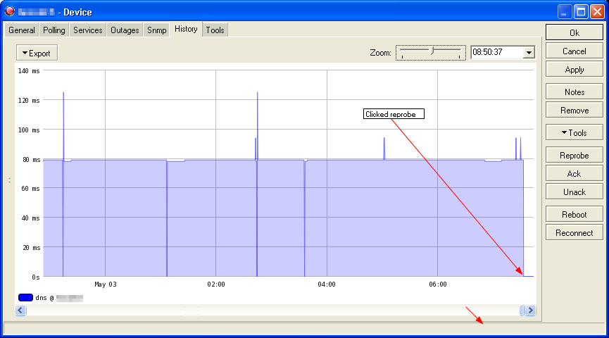

You will find a lot of weirdness with ping times. My servers are all under 1ms but often ping is anywhere between ~15 to ~80ms. There are interesting artifacts with this since if you re-probe the obviously incorrect response time will be reset to a reasonable value until sometime later.

Here is a DNS probe that was running about 80ms and clicking re-probe fixed it… for now.
So re-probe somehow bumps the current service to the front of the list.
