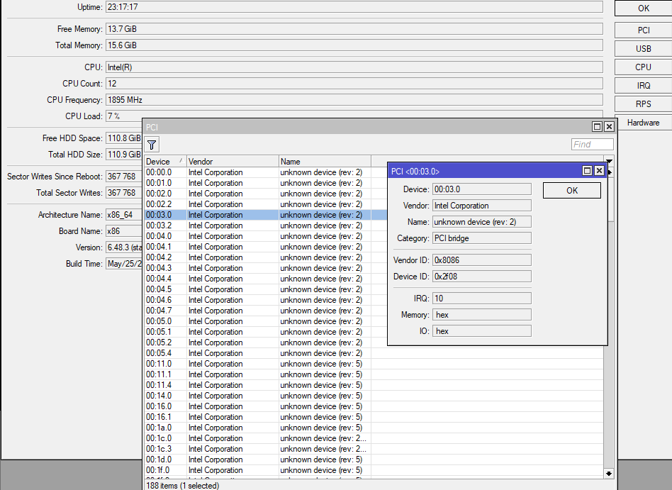

Hi.
Can anyone tell me what it is? Intel server, xeon processor, integrated 2 port network card (ethernet), and 3 intel x520 DA2 cards. 4 BGP sessions running and that’s it.
Almost all the time, even with low traffic ~ 100Mbps, one cpu goes to 100%, and this machine has practically nothing to do. There are a lot of unknown devices and I don’t know where from.
Please help.
The naming of devices has nothing to do with their proper functioning in linux in general and in ROS in particular.
For naming linux uses PCI IDs database, available from https://pci-ids.ucw.cz … you can browse the database by ID and you’ll see that device from your screenshot is “Xeon E7 v3/Xeon E5 v3/Core i7 PCI Express Root Port 3” which usually doesn’t need any driver to work properly.
For proper functioning a proper driver is usually needed (and driver identifies devices it can drive by numerical values so it doesn’t need PCI IDs database). Many times ROS doesn’t include driver for a device which is properly identified (and named). It is possible (not under ROS) that there is driver available for a device missing from locally available PCI IDs database.
